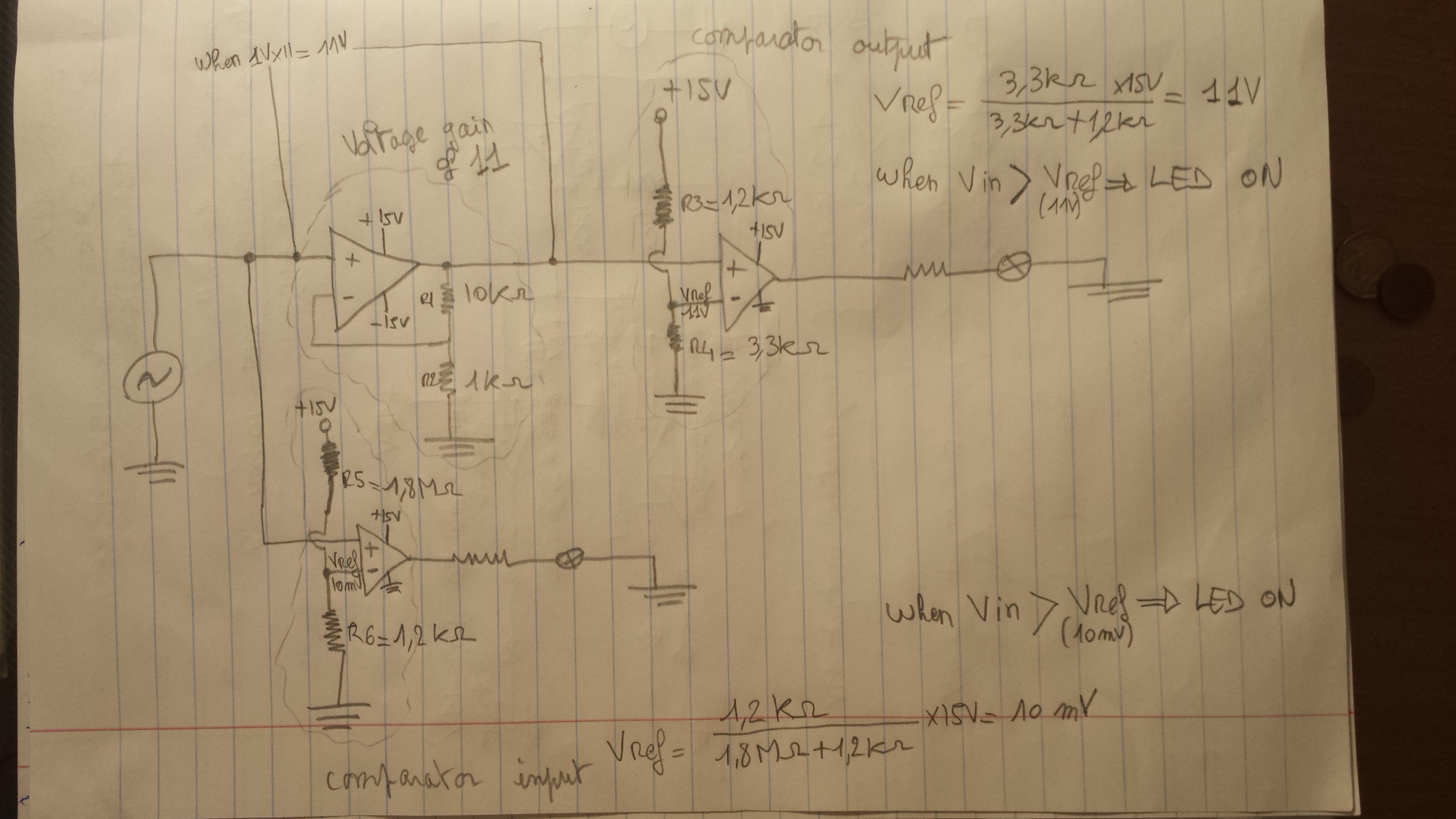

Hello everybody, I will have a work about op-amps. I must design a non-inverting amplifier with a voltage gain of 11. When the input voltage is larger than 10mV a LED must illuminate and when the output reach 11V a LED must illuminate also.
Actually we didn't do op-amps as comparator in class yet, so I started to check by myself on the net and in my electronic book.

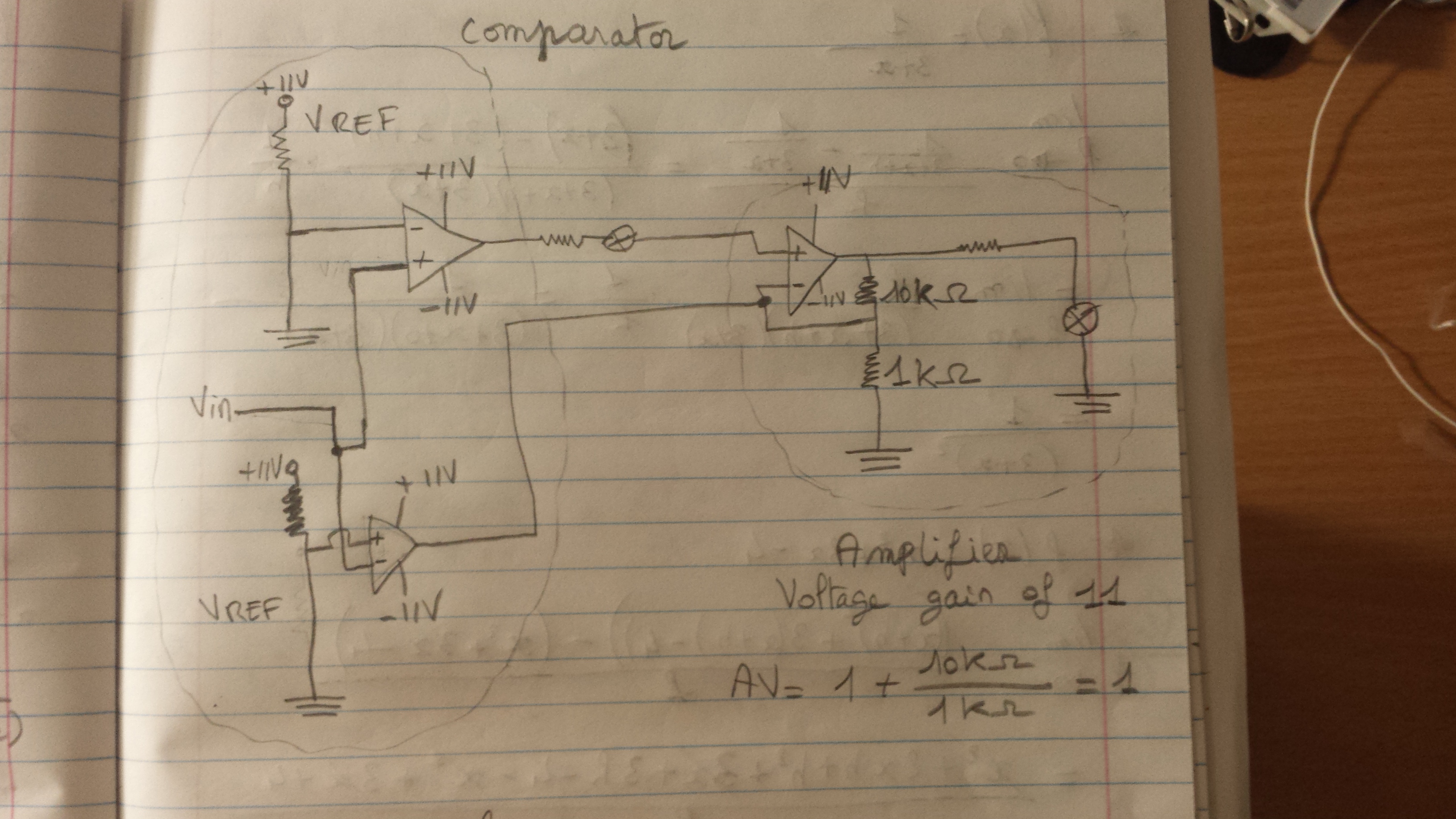

But I am sure at all if I do understand. I tried to draw a design using 2 op-amps (lm741) as comparator for the input and another one op-amps (lm741) using the inverting as feedback to reduce the voltage gain at 11 and amplify.
Is my drawing definitely wrong?
thank you very much. :)

your drawing is an attempt at a window comparator feeding an amplifier with a gain of 11. you have your reference at ground and you have supply voltages of only 11V. You will need rail to rail opamps to get close to 11V output using an 11 V supply.
As Joe noted you need a higher supply voltage with a 741.
The old 741 output can go no closer than about 2-3V of the positive and negative supply voltages before the output saturates.

I thought to use a window comparator because the voltage at the input is very small to compare (10mV) with one op-amps, is it a bad idea?

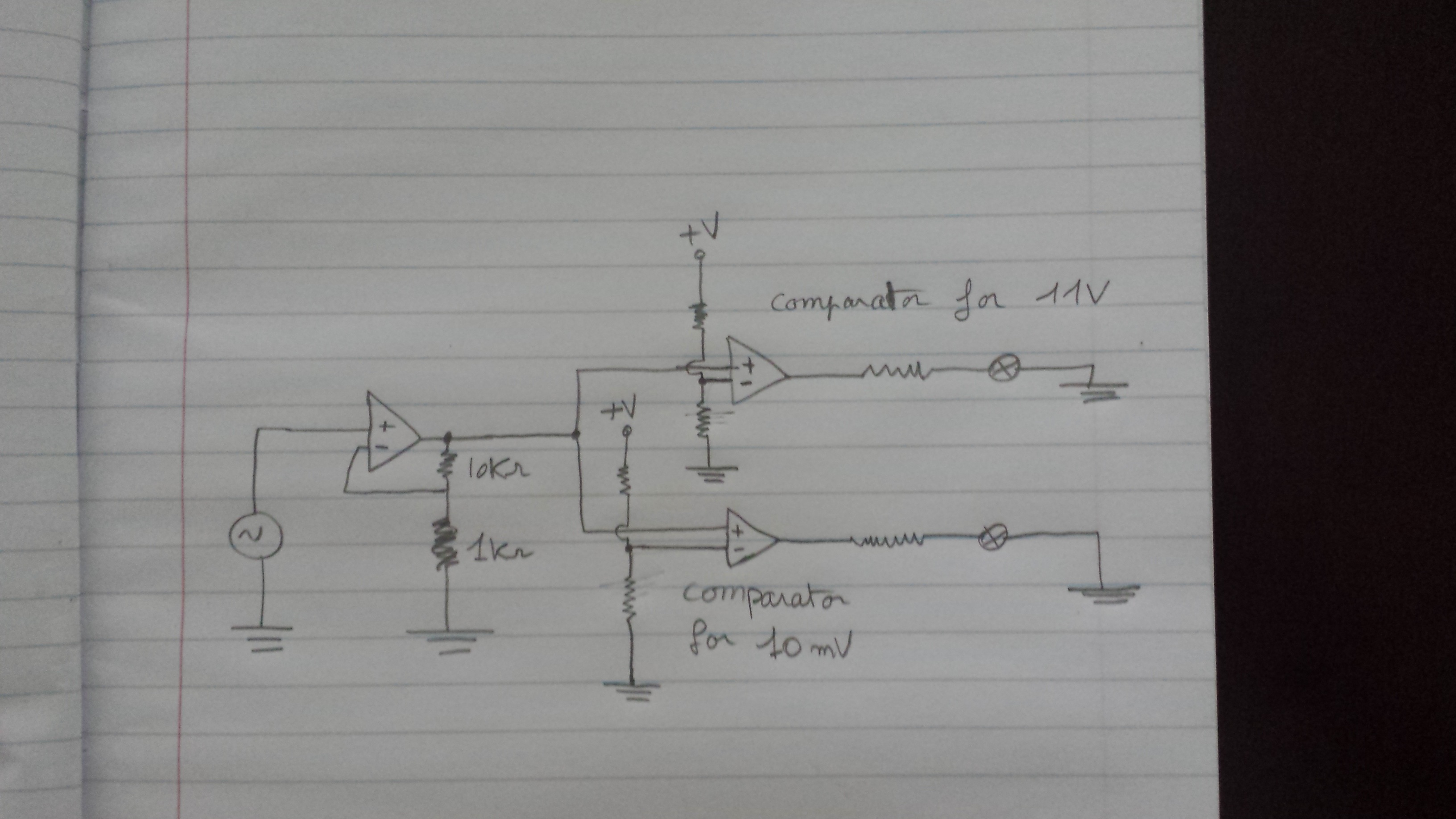

I tried to redraw my circuit, does it make more sens?

That is one way. Your reference could be a single string of resistors, using three resistors. However, being restricted to the E12 series, it might be best using it the way you have it drawn.
With my comments on the output voltage ... it was the output of the x11 amplifier. With 15V supplies, you will get 2-3 volts lower than 15 volts at the output of that amplifier.
Go ahead and fill in the remaining values of the resistors. Repost your schematic when your done.
Are you using a single or dual (+ and -) 15 volt supplies?

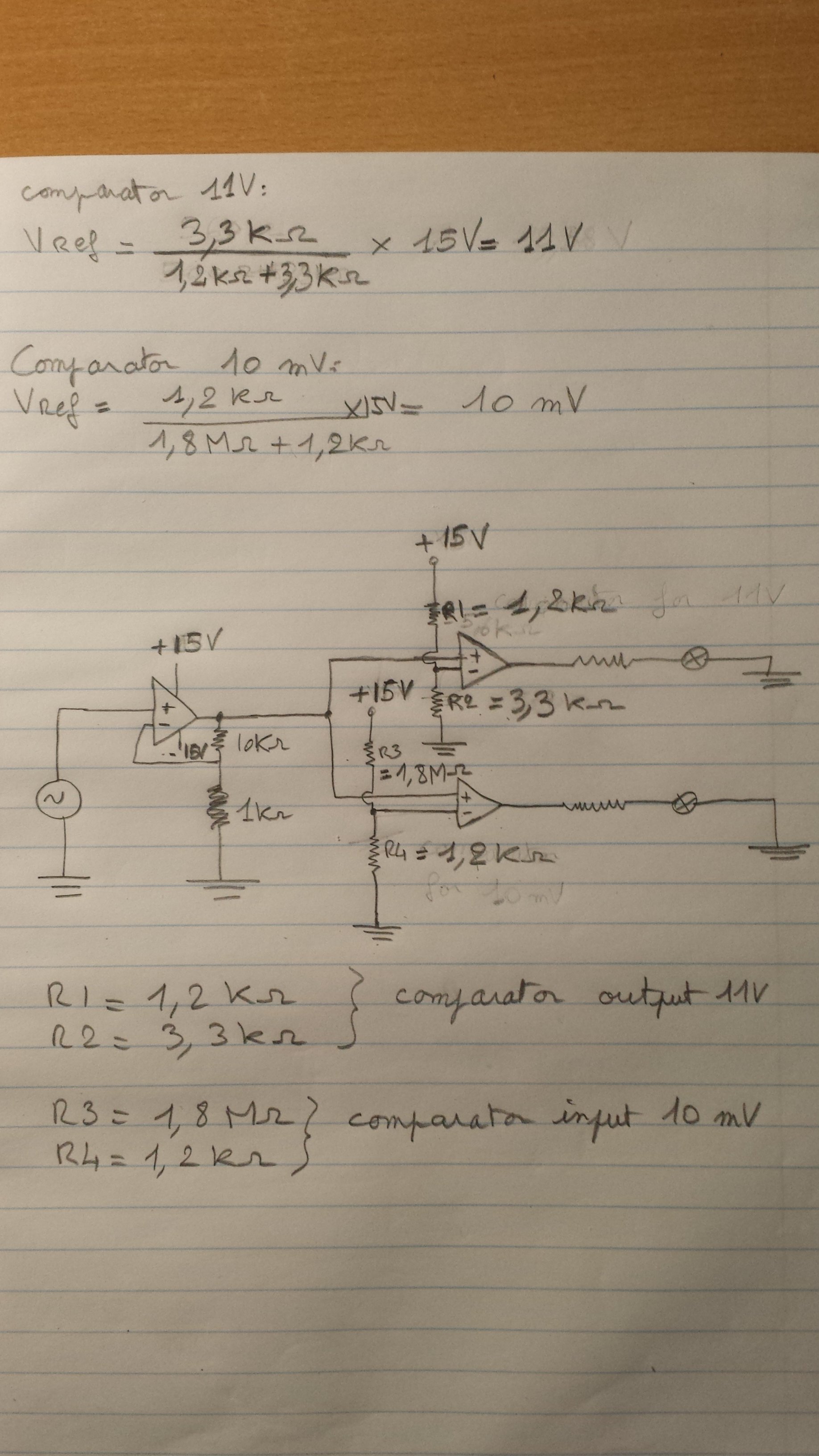

I repost the schematic with my resistors value, and also the list of the resistors that I am allowed to use.

You calculated the 10 mV input improperly.
Correlate your diagram to the problem statement.
Do you see the same picture? maybe I did a mistake. One picture in the list of the resistors that I am allowed to use.
And the second picture is my schematic with my chosen resistors.

Look at the words on your problem statement. You should be able to point each of those, plus more, on your schematic.
That's true... With this drawing I have 2 output comparator and none one output/one input. I think I see my mistake thank you. But can I keep these resistors value for my input voltage divider comparator?

If you have a 9 mV DC signal at the input to the amplifier, what is the output of the amplifier, and is the low LED energized?
No. That is not how you designed it.
With 9mV at the input to the op amp, what is the input voltage to the comparator?
Re-read your requiements.

There was nothing wrong with the previous topology.
What you had incorrect was Using 10 mV as the threshold.
I wanted you to realize the 10 mV into the x11 amplifier produced 110 mV at the output and 110mV was the threshold you needed and not 10 mV.
What input to the amplifier causes the amplifiers output to be the maximum voltage ... Assume the maximum voltage to be two volts lower than your selected Vdd.
Ha yes of course it makes a lot of sense... sorry to didn't see this mistake.
(for the 11V output comparator) 1v to my input causes to be the maximum voltage to the output because 1v * 11(AV) = 11V and the threshold is 11V.
With 9 mV input, the output of the amplifier * 11 = 99mV, with my wrong threshold is 10mV<99 mV my LED is ON.
