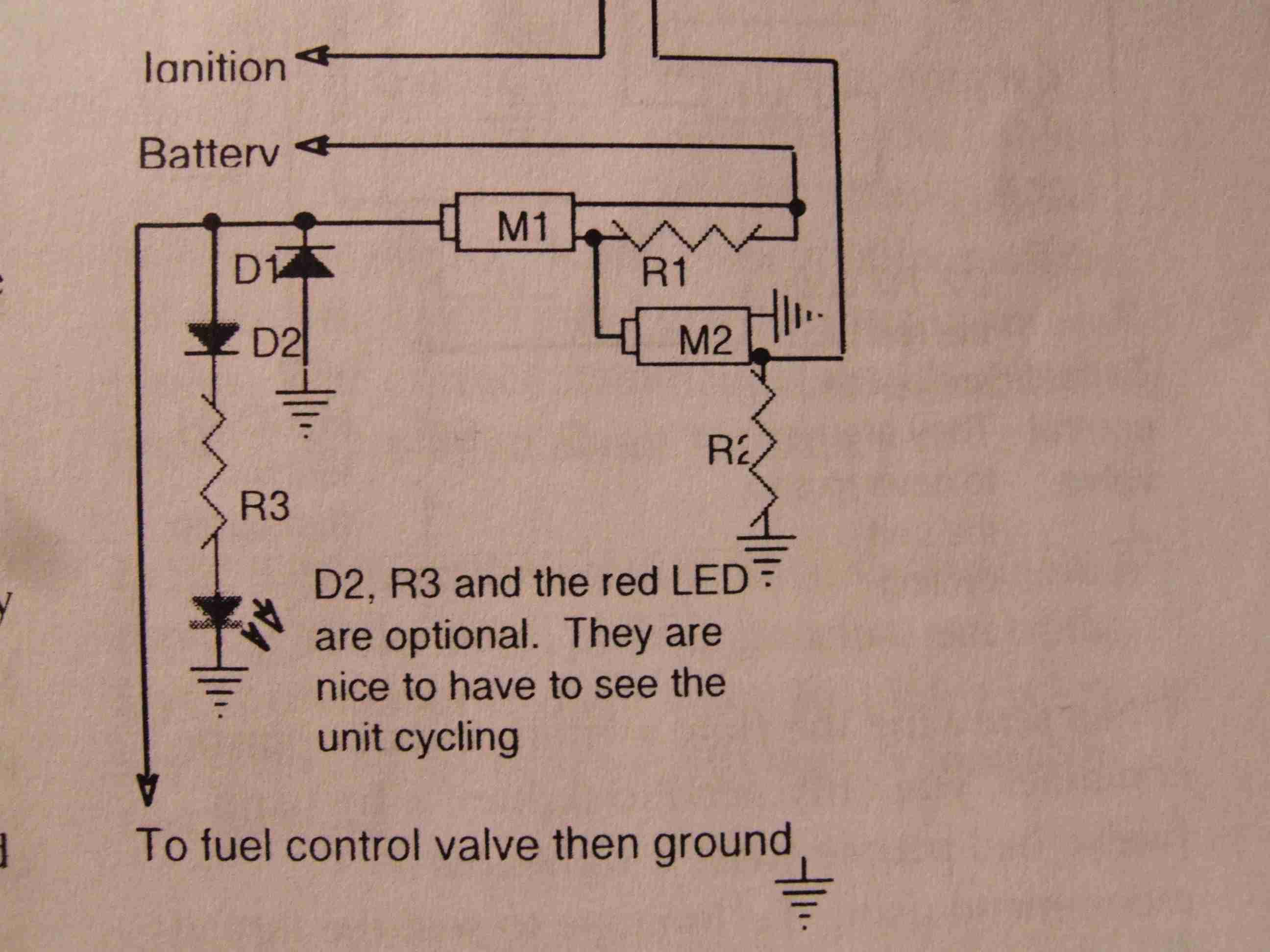

I came across the following Mosfet circuit, but am unfamiliar with the Drain, Gate & Source connections; which is which? Can anyone out there, shed some light on this?
This circuit has a float switch (not visible in drawing)
M1 = IRFD9014
M2 = IRFD014
R1 = 500K
R2 = 10M
R3 = 1K
D1,2 = 1A, 400v diodes
Thanks in advance.

Given:
M1 = P channel
M2 = N channel
Found using a Google search for the part numbers.
It's fairly obvious to me which connections are which.
R1 and R2 are pull up/down resistors which connect to the gates.
The P channel will have the source going to +V and the N channel will have the source going to 0V.
M2 simply pulls M1's gate down so it's drain goes to M1's gate.
M1's drain goes to the load which is the LED and the fuel control valve.

Edit: You mentioned that "The P channel (M1) will have the source going to +V" and then later, "M1's source goes to the load which is the LED and the fuel control valve."
If the first statement is correct, then by inference M1's Drain actually goes to the load, which are the LED and the fuel control valve.
Sorry, I made a mistake, I meant that M1's drain goes to the load.
Generally when using MOSFETs the load is connected to the drain because the voltage loss is lower.
