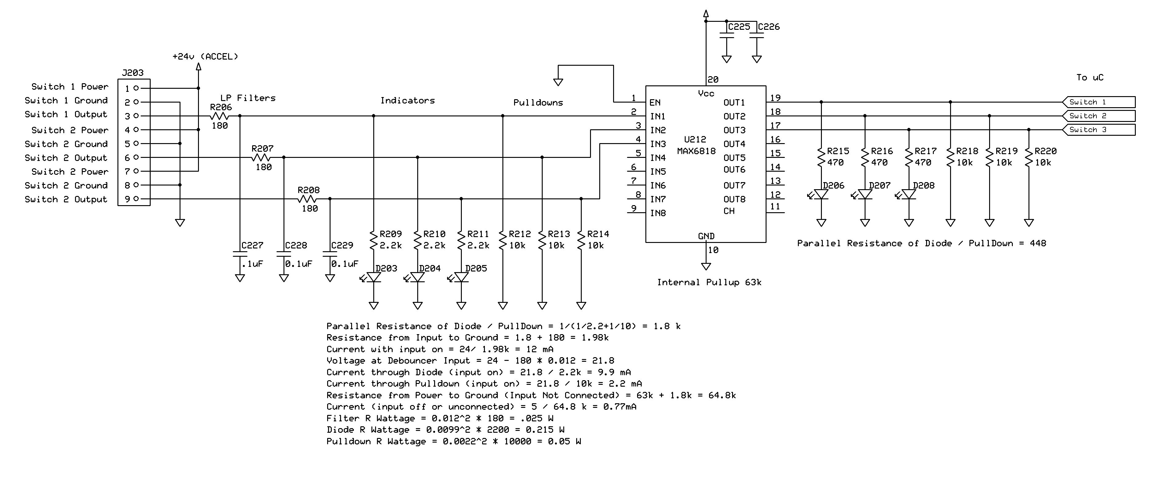

Ok, I am redesigning this circuit, and I wanted to add a few things, including a debounce ic, and an indicator LED and possibly reverse polarity / overvoltage protection.
The data sheet on the debouncer says its input current is 1mA at 15V. I calculated 12mA through the filter (see diagram for calculations. How does this current 12mA relate to the datasheet info (1mA at 15V)? Does anyone see any other problems with the values of the resistances?
How would I (and i don't know if it is worth it) protect the input against someone trying to put 120VAC into it?

If the path from J203 to U212 is a physically long one (lots of area to couple noise), then place your filters right at the input of U212.
Also, use a ground plane. I dont see any issues with your resistances.
If you want overvoltage protection, put suitably rated TVS diodes on all of your lines and place a fast acting fuse in series with your lines at the connector. The TVS diodes (with a good layout) can limit the voltage to a low/safe level within nano-seconds. If there is a sustained higher current from said overvoltage, the fuse will open removing the condition. The fuse should be rated for the standoff voltage. If the 120VAC you ask about is mains, I would rate the fuse for 250V ( a standard rating)

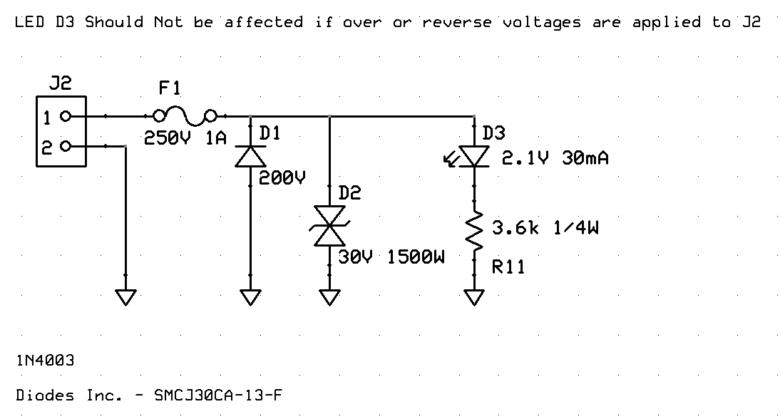

Should i use this same method to protect the power input to the whole board ( also 24V) or is there some reason why people use a simple schottky diode in line or I have even seen a backwards transistor ( hooked up reversed)? I have had two of the boards i built fried b/c someone hooked them to the wall instead of to a 24 v supply!

For protection you can use a TVS (transient voltage suppresor) diode and a fast-blow fuse. Put a 30V bidirectional TVS zener diode (fast response, they are on digikey) in parallel with the 24V switch lines, and then a fuse between that point and the main power connector. If someone hooks up anything > ~30V the TVS clamps, fuse blows.
This will handle the current just fine until the fuse blows.

Finally got around to trying this, and the results are in! I built the following circuit, and it protects against 24VDC reverse voltage, but if i hook 120VDC up to it (just rectified mains to try dc before trying 120VAC) it fails. The TVS is no good anymore, fuse blows even at 24VDC correct polarity. Do you know what might be causing the problem?
