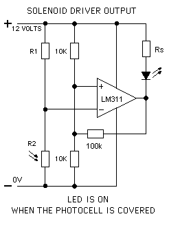

This will work.

A comparator makes a lot more sense though you won't be able to adjust the brightness with that circuit.
Your current limiting resistor (R2 470K) is way too high. you need to use ohms law to calculate that. Add up the voltage drops of the LEDs, subtract that from the supply voltage and use what's left to calculate the resistor value based of the current you want flowing through the LEDs. Example: 2V Vf on LEDs, 8V total. 18-8 = 10V. LED If is 20 mA. R = V/I = 10/.02 = 500 ohms. Use standard value - 470. Note that you will lose some voltage from the transistor or comparator so the "correct" value is likely to be pretty close to 470.
I wouldn't use a 9V battery - they have little capacity and won't last very long. I'd use 4 AA cells for significantly longer run time. You can run 2 parallel sets of LEDs - each with their own limiting resistor if you don't have enough voltage.
Finally, there are LED power ICs that will give you a lot more flexibility on your power source and will be more efficient than using limiting resistors. More complex to design with, though. Some of them support dimming as well.
Yes you can, just alter the value of Rs.
That is true though you have to take a little care - its more than just using a potentiometer for Rs. There needs to be a separate series resistor in addition to the pot to prevent setting the current too high. I presume that he wanted to be able to adjust the brightness of the LEDs.

I Decided to try the comparator. I have had it working for about a week now with no problems. I can adjust the point win it comes on very nicely with
100k pot. I turned all the lights off and it will not come on till the tv is off. It has to be pretty dark witch is what I wanted. If you see anything that is not quite right or needs to be changed. Please let me know.
Schematic
D1,D2,D3,D4 LEDS are blue 3.5vf forward current 30mA
LDR Dark 500k ohm light 15k ohm
LM339 Quad Comparator just using one set of inputs. I also tryed 741 op amp with out the pullup resistor and it worked also.

The LM339 doesn't output enough current to power the LEDs.
The LM741 might be able to do it.
If you used an LM339 with a 1k pull-up resistor the LEDs would be very dim anyway. The current through each LED would be only 810:mu:A.
For brighty LEDs:
  • Use an LM311.
  • Replace R1 with the LEDs R4 and R5.
  • Swap the inverting and non-inverting pin connections.
R1 in parallel with R2 (R1||R2) is 5k, so if the output swings 9v the hysteresis is 9v (5k/100k) = 0.45v.
