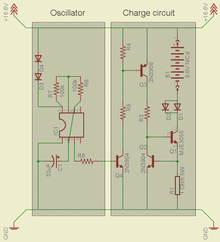

Long story short, I don't have a good enough charger for my several 8 cell NiCd battery packs and as the result the batteries (and plane I used them for) went mostly unused for a couple years.
But with a renewed interest (and better knowledge of electronics) I decided built a battery charger for those NiCd packs(circuit attached) using only the components I have on hand and would rather to keep it as such.
From what I've read on NiCds, when charging they peak at a voltage of 1.6V per cell when they reach full charge then start to fall slightly so for an 8-cell pack that peak voltage would be 12.8V.
Another thing that I found was that NiCds respond to charging better if it's pulsed.
The circuit I built uses a constant current circuit found here but uses a power BJT rather than a FET.
I added extra transistors (Q3, Q4) so I can pulse it on and off.
R1 being 1Ω sets the current to about 500-600mA. The power supply is regulated supply rated at 16V, 4A.
The IC is a LM555 with a rated max supply of 16V so I added D3 and D4 to drop it into a safe area. I plan on replacing them with a 6V regulator.
The circuit works and the batteries respond very well to the pulsed charge and peak at ~12.8V as expected.
But my problem is is that it has to be watched. I need a circuit that shuts down the charging circuit(or oscillator) when the battery reaches 12.8V. I was thinking of using an LM1458N OpAmp I have from another project but I am not very familiar with opamps.
I just need something to change states when the battery reaches a set voltage using either that opamp or simple components.

You can use the op amp or you could buy an inexpensive comparitor to sense the voltage. Then you will need to either build a latch out of and gates or use a latch ic to remember it was fully charged after the charger turns off. Might need a switch to reset it or maybe we could reset it when the batteries were removed. Does something like that sound like a plan?
Looking for the peak delta voltage to terminate on an 8 cell string is dangerous because they don't peak at the same time. You might never reach to maximum voltage. You are better off monitoring cell voltages and terminate when the cell temps start to rise.
The NI-CD chemical charge reaction is endothermic which means the cell gets slightly cooler (even at high charge rates) so the rising cell temp is a fairly reliable termination method. I used to cut the fast charger at cell temps of about 5C above ambient then shift to a low trickle charge rate of about c/20.
I'll try to find the article I had published on a fast nicad charger.
Here is an article of mine about building a fast NI-CD charger with automatic shutoff the prevent overcharge. I think it was published late 90's.
I also included bench data on the voltage/temp profile of a typical ni-cd cell subjected to 1.2C charge rate. It shows where a good point to stop is. On mine, the peak cell voltage only got up to 1.736V.

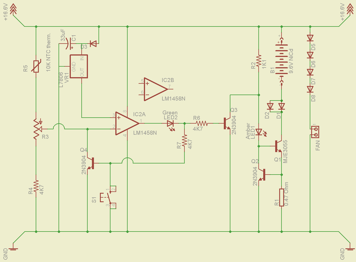

I looked into Opamps again and found it easier to understand than the last time I tried.
It's apparent that I won't get unwatchable charging by relying only on voltage unless it's setup to to detect a fall in voltage so I think I'll go with using that opamp to detect a rise in heat.
But until I get a thermistor, I'll just have to monitor them while they charge.
When I do get a thermistor, this will likely be my circuit.
Edit: Come to think of it I don't think the inputs should be pulled that close to supply.
No.
The inputs are over 10V from the supply which is plenty of extra voltage. The supply is 16.6V and the voltage regulator will be 6V if it has an output capacitor and an output resistor to ground.
I was actually referring to the Inverting input. I set it up to lock itself high by using Q4 to pull the inverting input directly to ground.
The allowed input common-mode voltage range for the very old LM1458 dual opamp is 3V above the negative voltage which is 0V in your circuit. Q4 forces it lower than 3V so the inverting input will stop working and the opamp will not work properly.
An LM358 dual opamp has inputs that work at 0V in your circuit. Its pins are the same as the LM1458.
The LM1458 actually does work as intended in this circuit despite being out of it's operational parameters though I will pick up an LM358 to ensure it's functionality and reliability.
