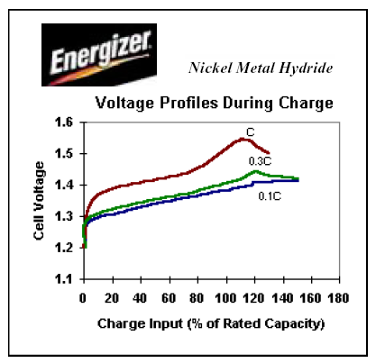

Here is the voltage of a Ni-MH cell charging at various currents. The graph is from Energizer Battery Company:

There is nothing at all wrong with a charge circuit such as the OP shows, as long as the voltage limit is set correctly.
At that, the current should drop to a low trickle by the point the cells are fully charged, so no voltage drop detection is needed. The voltage curve would be somewhere between the blue and green lines in your image.
The blue and green charging curves in the image I posted merge and level out at a charging current of 0.15C.
But Energizer Battery Company and Battery unoversity.com say do not trickle charge at more than 0.025C.
Which it will not do - as long as the voltage is set properly!
That circuit has no continuous trickle facility, it will only cut it if the voltage is too low.
When charging, the current will taper to nothing as the cells come up to the set voltage.
