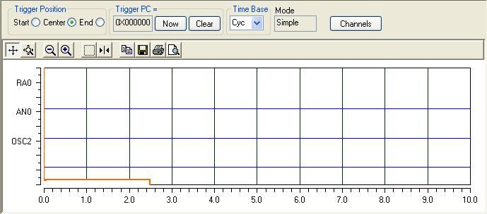

I tried to write a programme for 18F452. The programme is supposed to generate a pulse train of 30% dutycycle.
I tried to simulate it in MP Lab IDE.

When I tried to observer the RA0 pin in the logic analyser applet, all I got was a straight line.
Please help :(

Okay I tried to do it...And it builds and runs properly...
Except that I do not see any waveform on the Logic Analyzer when I try to observe AN0 or RA0
Please help...
Logic Analizer
Here is a picture of the Logic Analyzer

I had used bcf PORT A,0 before changing it to bcf LATA,0
And it made no difference in the simulations... Both the commands changed the LATA register... It looks like the PORT A is the input Register and LATA the output.
