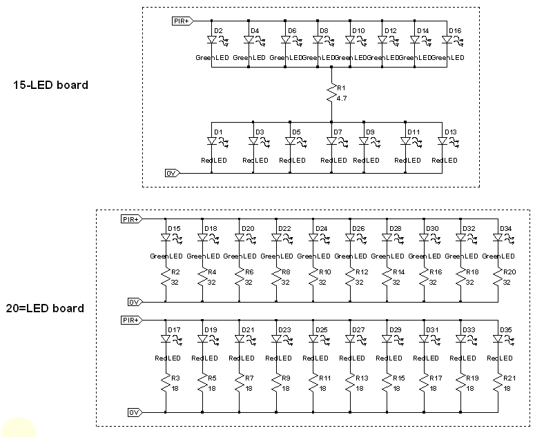

Okay, I do not know how to draw a circuit so I will try to explain how the board is made.
On the 15 LED board, all LEDs are in parallel. The board is a rectangle. Originally both of these lights were security lights with white LEDs. I changed out the LEDs for the colored ones. There are 8 green LEDs that are on one side of the board and that is where the power hooks up. Then I cut the board and installed a 4.7 ohm resistor between the two sides of the board. The other half of the board has 7 red LEDs. Without the resistor, only the Red LEDs would come on. The forward voltage of the green ones is 3.2 to 3.4 volts and the forward voltage of the red ones is 1.9 to 2.0.
On the 20 LED board. Again all of the LEDs are in parallel with a resistor on each LED. 18 ohms on the red ones and 32 ohms on the green ones.

I'm still unclear as to your setup. Are you saying the 15-LED array shares only one resistor, or does each red LED have its own resistor? Do the red LEDs form one parallel array and the green LEDs another parallel array?

The LED board had no resistor originally. There is still no resistor between the green leds a d the pir circuit. The only resistor is the 4.7 I installed between the green end of the board and the red end of the board. Just one resistor between the 2 halves.
The reason for the low resistor on the red LEDs on the 20 light is to make the red lights as bright as the green ones. Since these LEDs can run 100 ma, we were able to make the red LEDs run more current than the green ones . Usually the red ones aren't as bright as the green ones
OK. That explains the resistor values. I'm still not sure of your board wiring. From your description the boards seem to be like this:-
Can you confirm that?
If not, can you post a clear .gif or .png image of the boards?
