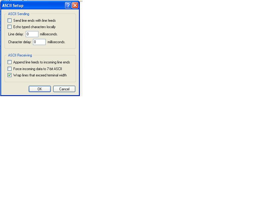

When I type something into Hyperterminal, it should come up on the screen and be transmitted right?
No, it shouldn't be displayed on the screen, only if it's echoed back by the other end - this is normal, and proves it's all working if the character appears on screen.
But how come nothing happens when I press a key (I am checking using an oscilloscope the serial port output). Nothing comes up on the screen, nor is anything transmitted through the port?? :confused:
Do you have handshaking set to NONE.

That depends if your properties are set for full or half duplex operation. Attached is the properites panel where you can have hyperterminal do a 'local echo' (half duplex mode) of the characters typed from the keyboard (click on the echo option). In full duplex mode (no local echo selected) you have to rely of the receiving end echoing back characters that you type and that is a function of the software on the receiving device, to echo back the chararcter or not.
As far as nothing being sent when you type, check for none as a handshacking option as already suggested.
Also you have to make sure the baud rate and bits/stop bits configuration values are the same for both the sending (hyperterminal) and the receiving device.
