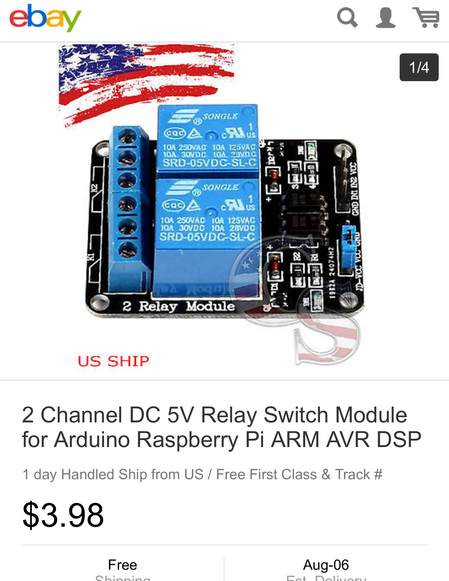

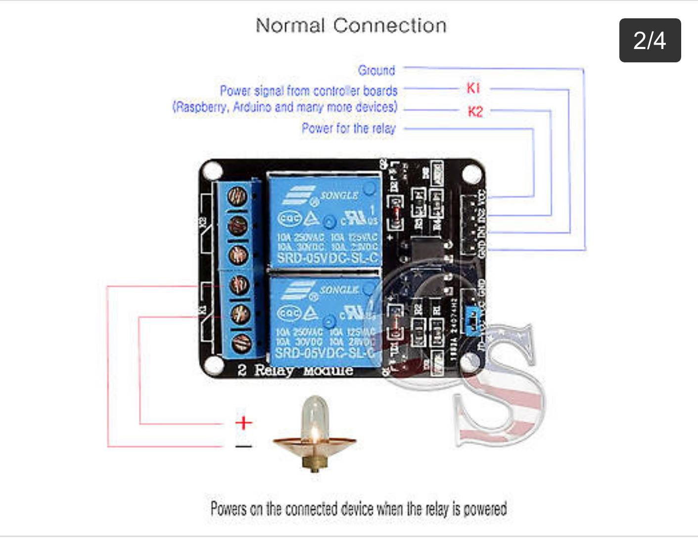

Depending on what you're trying to do, a module like this from ebay may be your best bet. the relays are driven by a transistor on the module, so there's no worry about drive current, and the contacts are brought out to terminal blocks, so there's no worry about the current carrying capacity of the bread board. These modules are far cheaper than the cost of the parts to build one yourself.
JonSea;
I definitively think that modules like the ones that you posted are the way to go.
Not only can you get them at a cost below that of individual components, but the a breadboard will not have the current capabilities required to switch a motor reliably.
I'll still have to buy other individual components because the system is more complex than that specific relay module.
