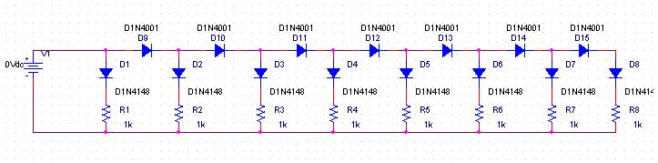

I remeber doing something similar to this in my EE lab. What we did was placed a regular diode in with the LEDs and used the forward voltage drop of the diode to control the voltage at which each diode turns on.
Here's a schematic, the 1n4148s are my leds and R1-R8 are the current limiting resistors (values to be determined).
Does it sound like this will work?
oh yeah, my leds have a forward voltage of 3.5V and normal current of 20mA

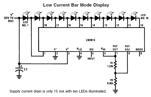

Hi Jeff,
The LEDs in your circuit will change their brightness a lot with a changing input voltage.
National's circuit needs a supply voltage doubler, uses 2V LEDs but can drive five or six 3.5V LEDs and should look pretty good:

thanks for the reply Mr Guru, I'm aware that the brightness of each LED will vary, but I was planning on hiding the led bars themselves and just using the reflected light. So the varying brightness will be good.
Also, I dont have much room to stick an IC in there, and I want to keep it as simple as possible by only having to run 2 maybe 3 wires to each bar.

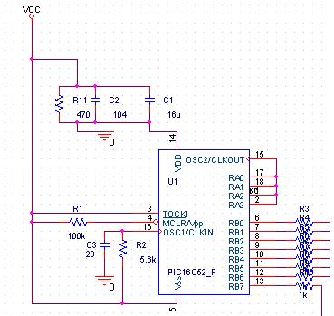

I drew up a schematic of the original circuit used to drive the LED's, where exactly does the pic get it's clock from? I'm assuming its just a simple RC circuit? (also pins 15 17 18 5 and 6 arent used, I just used a wire to indicate that.)
Would it be possible to have the pic run off the clock of my roof LEDs (the output of a lm3915)?

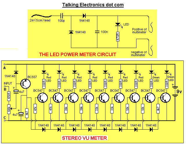

go to talkingelectronics.com interactive site
they have a Stereo VU meter with the circuit diagram. It converts sound into a visual volume indicator. The louder the sound, the brighter the LED.
Talking Electronics have an LED RF Power Meter project that rectifies RF and changes the brightness of an LED according to the level. Its 100pF input capacitor is much too small for audio frequencies.
They also have a Stereo VU Meter project that works about the same as the bar-graph circuits that Jeff and I posted since it changes the number of lighted LEDs according to the level. Like the LM3915, it doesn't change the brightness of the LEDs.

But I'm just wondering if it possible to have the clock for the pic be generated by an Lm3915 so that the pic would respond to the music as well.
You might need to level-shift and speed-up the output of the LM3915 with a Schmitt-trigger inverter. :lol:
Instead of having the LM3915 drive the clock input of the PIC you could have it drive a timer input. This would let you vary your speed through software without messing with the temperamental clock input.
The pic is pre-programmed, it's actually a CF745-04 but I found a datasheet that said it could also be the one I used in my schematic. Also, I've never programmed a pic before, so I think thats out of the question for now.

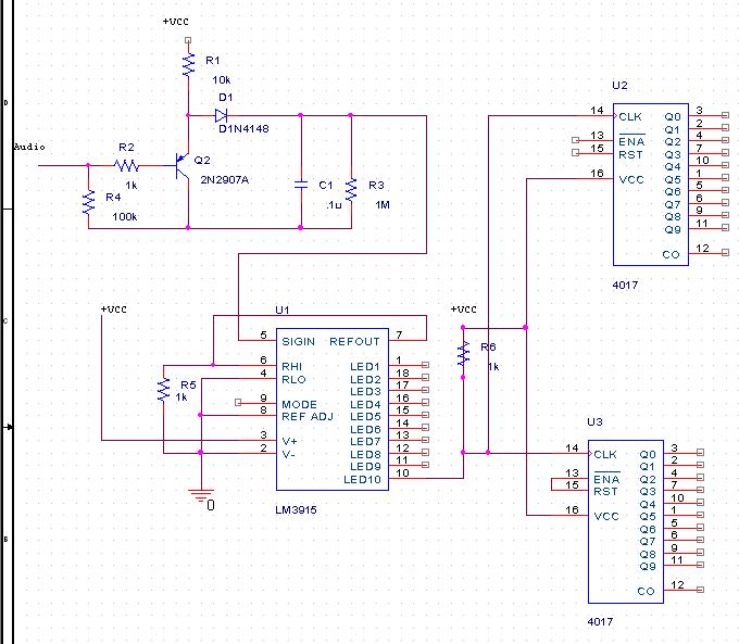

Ok, I finally have the schematic for the circuit that Im using for my leds.
The clock and data in for the shift registers are attached to one of the counter ic's
So no how would I hook it up?
EDIT: I know Im missing a few connections on the counter IC's...too lazy to finish it in pspice

Hi Jeff,
Since you aren't using the LM3915 as a VU meter, level shifting isn't necessary, in fact even the fairly expensive 18 pins LM3915 could be replaced by a cheap 8 pins single-supply opamp wired as a comparator.
The 2nd half of the opamp (dual one) could buffer and amplify the output of the 2N2907 circuit, drive a transistor and change the supply voltage to the LEDs so that their brightness follows the volume of the music. :lol:
What will the Pic do?
The pic changes the patterns that the leds light up and makes them flash. I figure if I can control the clock of the pic with my audio signal then it will appear that the leds flash with the music. Is it possible to run a pic like that?
PIC's can have the oscillator speed changed whilst running, and will work from DC up to their maximum speed. By using an exernal voltage controlled oscillator you could vary the speed of the PIC over a VERY substantial range.

ok, so going back to the schematic of the pic, what is the clock speed of it right now? could it just use a simple RC circuit as the clock?
