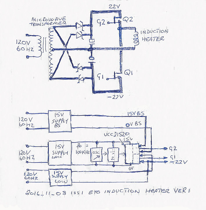

New Induction Heater circuit with no center tap.
Does the OSC set the KHz of the Flip Flop?
Yes.
The oscillator frequency is 200Khz which you can adjust by the variable resistor. The 200KHz signal from the oscillator connects to the clock input of the flip flop which divides the clock signal by two to produce 100Khz to drive the transistor driver chip. (you can have any clock frequency you like, within reason, if 100KHz is not suitable).
The flip flop not only divides the frequency by two, but it also produces two antiphase clock signals (CLOCK and /CLOCK) which the driver chip requires.
The flip flop ensures that the clock signal clocks have an exact 1:1 mark to space ratio, with fast rising and falling edges.
Having an external clock generator ensures that the frequency of the signal in the induction coil is constant and the frequency is not pulled by items placed in the coil's magnet field.
The clock generator is dead simple to build and is well-behaved.:)

In this design there is no resonant frequency and no capacitor. That is the thing about this approach: you do not rely on the coil osculating with a capacitor to generate the switching waveform. But you may have some capacitance on the coil to smooth the edges a bit.
The 100Kz frequency to drive the bridge is only notional. By experimenting you will probably find an optimum frequency to suit a particular coil and transistor type. That is one of the advantages of this circuit you can change the parameters quite easily.

Gary, it seems to me that there are two good approaches for your induction heater:
(1) Full bridge: four MOSFET/IGBT
(2) Half bridge with +- supplies: two MOSFET/IGBT
I think (2) has a lot of benefits so, for your consideration, I knocked out a quick block diagram to illustrating the approach using a single UCC21520 chip and two high power MOSFET/IGBT:
I have been a bit lavish with the 15V power supplies, and while two are not absolutely essential, they do give complete isolation between the logic and bridge. They also improve performance and make the operation of the circuit easier to understand. And PSUs are dirt cheap on the net anyway.:)

This diodes still do not look right to me. With the diodes like they are it produces a pulsing DC wave. I though an induction heater worked by changing the magnetic field, N, S, N, S, N, S, N, S, N, S, N, S, N, S, N, S, N, S, N, S, N, S, N, S, N, S, N, S, at 100KHz?
2016_11_08_iss1_eto_induction_heater_ver1-jpg.102184
That is not correct Gary. The split transformer secondary, four diodes, and two reservoir capacitors are a very widely used power supply configuration that produces positive and negative DC voltage supply rails for the half bridge. By the way, the capacitors will need to be very large with +22V and -22V supply rails, about 1F. They would probably best be made by connecting 10 of 100mF (100,000 uF) capacitors in parallel. The reservoir capacitors would be a big cost unless you can salvage them from other equipment or if you already have them in your component spares box.:)
You are correct about the magnetic field in the coil being, N,S, N ... The half bridge does just that. For the N part of the magnetic field the top transistor in the bridge is turned on while the lower transistor is turned off. Then for the S half of the magnetic field in the coil, the top transistor is turned off and the bottom transistor is turn on. And so the cycle would continue so that you get a continuous N, S, N, S magnetic field in the coil at a frequency of 100KHz (or whatever frequency you find to be best to suit your particular coil).
I am more than happy to discus this circuit, but I would not like influence you one way or another, especially if you have doubts about this circuits suitability. After all is said and done, you have much more experience with induction heating coils than me. All my stuff is just theoretical.:)

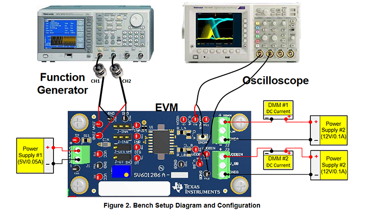

There is a UCC21520 module available all that is required is attach 2 wires from the 15v 4a DC power supply then run 2 wires from each output to each IGBT. There is an adjustment for dead zone time. I dont see an OSC and it says nothing i see about an OSC imput.?
Great board.:cool:
There is no oscillator. You would need an external oscillator like the one in post #60.
The inputs are marked, JINA and JINB at the left of the board.
