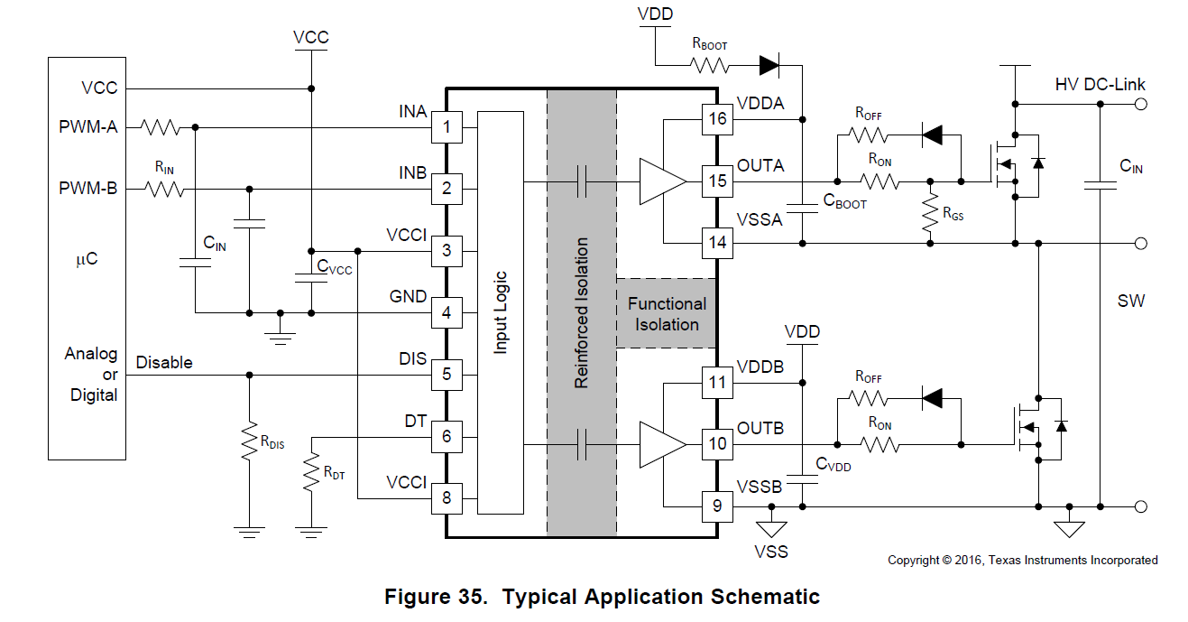

Here you are Gary from the UC21520 data sheet:
You just need two of these circuits and connect the untapped primary of your induction heater between the two outputs.
We can suggest values and how to drive the completed bridge- that is not the difficult part.
The difficult part is getting the gate drives right and getting the high-power transistors (MOSFET or IGBT) happy driving the induction heater transformer.

I understand what Dead Zone is that will be a much better circuit but never worked with this.
I have no problem with extra parts, I just don't know how to find the values of capacitors, resistors, diodes in that circuit.
What is the rectangle box to the left where it says, VCC, PMW, uC, Analog or Digital?
I don't know the abbreviation, VCC, VDD, VSS, SW?
I think HV DC link is probably the power supply?
Where does the load coil connect and does it have a capacitor bank like the mosfet circuit?
What is the symbol to the left of HV DC Link it looks like an Antenna symbol?
It is just that- a box showing lots of options. It is a general way to shoe how the various signals could be controlled. In your application you would have just one in[put from an oscillator and that would be it. No sweat. It may look complex if you are not familiar with this part but there is nothing complicated really. As I say, we can show you all the connections you will need.
This is dead simple: VCC is the positive supply line for the logic on the chip. The ground symbol is the negative line of the same supply.
VDD is the positive boot strap supply that is generated to drive the top transistor gate with enough voltage to turn it on.
VSS is just the bridge 0V line (earth or chassis).
SW stands for switch and is just sloppy labeling. It is the output from that half of the bridge (where one end of your coil would connect).
That is correct. It is just sloppy labeling again.:)
One end of the coil connects to the point marked SW on the left half bridge and the other end of the coil connects to the same point point on the right half of the bridge. No capacitors are involved.
It is absolutely nothing- just sloppy drawing. You can rub it out if you want.:D
Honestly, although this chip and the signals may seem complicated, they are not. In fact, the way you will be using it will not be much different to other drivers you have used already

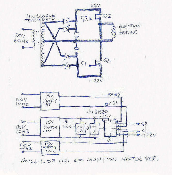

POST ISSUE 03 of 2016_11_14
Gary, it seems to me that there are two good approaches for your induction heater:
(1) Full bridge: four MOSFET/IGBT
(2) Half bridge with +- supplies: two MOSFET/IGBT
I think (2) has a lot of benefits so, for your consideration, I knocked out a quick block diagram to illustrating the approach using a single UCC21520 chip and two high power MOSFET/IGBT:
I have been a bit lavish with the 15V power supplies, and while two are not absolutely essential, they do give complete isolation between the logic and bridge. They also improve performance and make the operation of the circuit easier to understand. And PSUs are dirt cheap on the net anyway.:)
spec
ERRATA
(1) Change fo to 200KHz
(2) Change power supplies to 12V @ 1A

I have 1200W MOT wired for 21V already but no CT. I have a 1400W MOT I can make into 22V with CT. I was hoping to run the 1200V IGBTs on 120 vac with bridge rectifier and filter = 170 VDC on a 15 amp breaker. Low voltage is probably safer than to have a work coil running at 170V that might zap the heck out of someone.
Looks like 1 of the diodes is backwards.
Where do i get a 100KHz OSC .
What is divide by 2 ?
How many amps are the 15v PS ?
What are part values on diodes and capacitors?
Where does -22v go ?
What connects to the other 2 terminals of Q1 and Q2 ?
I would just put your TL494 IC in that spot and use it to generate the variable frequency and PWM for everything.
As for the power supply I have never ran anything but one 12 - 15 volt 1 amp unit for such control circuits on anything I have ever built. Although in your case being the driver IC's Spec recommends are fully isolated output devices I would run a separate power supply for that side of the system.
As for current limiting if you want to run your circuit on full 170 VDC power putting your coil tank circuit capacitors in series with your heating coil will work to limit your overall current draw through simple capacitive impedance as I alluded to and showed in my reference to the high powered H bridge systems used in the big welding power supplies.
Great. I only put in +- 22V supplies because that was on one of the schematics that you previously posted. The bridge plus and minus supply voltages can be whatever you like, but they must be the same magnitude and must match the V/I characteristics of your coil for maximum heating and efficiency.
:eek: From a safety point of view, you are only allowed to have a maximum of 30V exposed to human contact. Any higher voltage and you would need to insulate the coil, which would be difficult, but not impossible. I would suggest going for 24V, nominal (30V max), as this is an industry standard voltage. It will also fit in with a possible future approach of using lead acid batteries in parallel with the bridge +-22V mains supply to enhance the induction heater supply short-term current capability.
Well spotted- please collect your prize from the mods.:) (sketch corrected by the way)
Easy peasy- I will post a schematic tomorrow. Its getting late here. The divide by two just ensures that you get an exact 1:1 mark-to-space ratio of the input waveform feeding the bridge driver. By the way the oscillator should be 200KHz to account for the divide by two stage.
How many amps are the 15v PS?
Change PSUs to 12V at 1A (see ERRATA) Around 10 bucks each supply on ebay.:)
That will have to be analyzed and specified, but no big deal
-22V is the bridge negative supply rail.
What connects to the other 2 terminals of Q1 and Q2?
That will be calculated when we have details of the MOSFET/IGBT that you intend to use, but almost certainly a resistor with a diode in series with a resistor in parallel with the resistor.
As I said before, don't worry! There is a standard procedure for establishing the design and all the values. Then you will be able to build a good test-bed for your induction heating investigations.
I don't like to be a nag, but we will also have to work out an optimum physical layout to get the best performance, but from what I have seen of your work you are pretty good at the physical side.:)

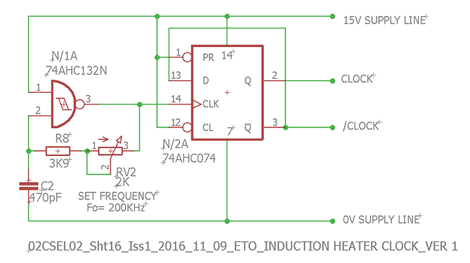

Hi Again Gary,
This is all there is to the oscillator and divide by two. The chips are hellish expensive though- about 30 cents each.:D
