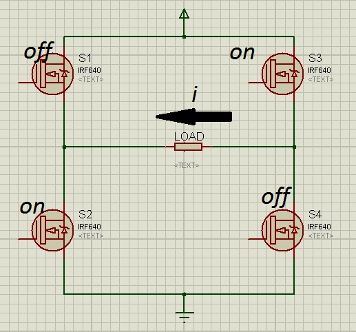

A common H-Bridge circuit design in many high powered inductive loads puts the main capacitor in series with the inductor so that it can work as a capacitive impedance current limiter of sorts.
It's a common design in inverter welders and some plasma cutters so that simple drive frequency changes will allow for stable and simple current limiting or regulation of the output. ;)
There is also a variant of that can be made where the second half of the H-Bridge uses two capacitors in place of the second two switching devices.
Also from what I see in your circuit it wont work as you have it drawn. You cant run a high side switching device off the same driver as a low side switching device is connected to. You have to use dedicated highside drivers to run the upper devices.

Gary, you need two low side/high side driver chips. It is not a good idea to drive two gates with the same driver line.
You would also be wise to provide a dead zone in the gate driving waveform. Dead zone is where all bridge transistors are off. This increases efficiency, gives the bridge transistors an easier time and reduces current spikes in the power line, like the top inductor would in the circuit above.

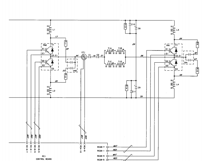

This is how Miller designs their high powered H-bridge systems in their equipment.
From here.
https://www.millerwelds.com/files/owners-manuals/O146741B_MIL.pdf
As you can see the output transformer's primary is in series with a capacitor (a pair of them actually being this unit runs on a ~600 volt DC rail voltage).
On their 230 VAC only input units all the way up to the XMT 450 series, that can do up to 600 amps @ 38 volts output (~23 KW output power) , they use the same .34 uF 1000 VDC nonpolar poly capacitors for C1 and C2 but in parallel for the lower input voltage.
From here.
As you can see the output transformer's primary is in series with a capacitor (a pair of them actually being this usint runs on a ~600 volt DC rail voltage).
You can see what a fully production design looks like from that schematic- lots of extra compensating, shaping, protecting, and optimizing components. This is the difference between a theoretical circuit and a practical realisation.

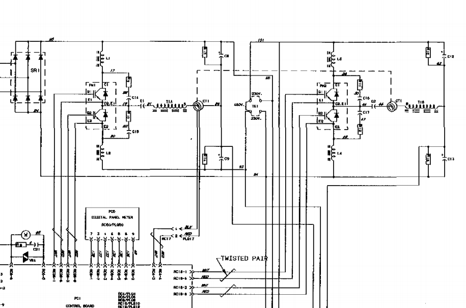

Now for the real head scratcher.
On Millers larger capacity and dual voltage welding units they use two H-bridges but only two pairs of High/Low dual switching device units rather than four as shown here for a typical XMT 300 suitcase welder unit but also applies on their higher capacity units as well.
From here. https://www.millerwelds.com/files/owners-manuals/O2205_MIL.pdf
Each H-bridge use two switching devices in one package for the active half of the H bridge and a pair of large HV poly capacitors to make up the second passive half of each H-bridge circuit so depending on which input voltage, 230 VAC or 460 VAC they are either running in parallel or series.
Now from a engineering standpoint that's a pretty clever way to get dual voltage operation in a HV high power H-bridge based SMPS system!:cool:
However from a experienced service techs standpoint I absolutely hated working on them being they were extremely prone to catastrophic burndown of the whole power and control systems. When one died everything related to power handling and control inside the unit got replaced.
There were no partial fixes. Ever. Input rectifier, both switching devices, main contorl board, output rectifiers and usually every power system related capacitor had to be changed out as well putting the off warranty repair bill as high as just buying a brand new machine. :mad:
I have two of their big uits sitting on a shelf in my shop that I could probably make one good uinti out of but I have never gotten around to it simply because to do so would require a total machine teardown to bare frame for both plus more than likely a few hundred dollars in aftermarket parts anyways just to have one functional machine that could still burn down again at any time.
