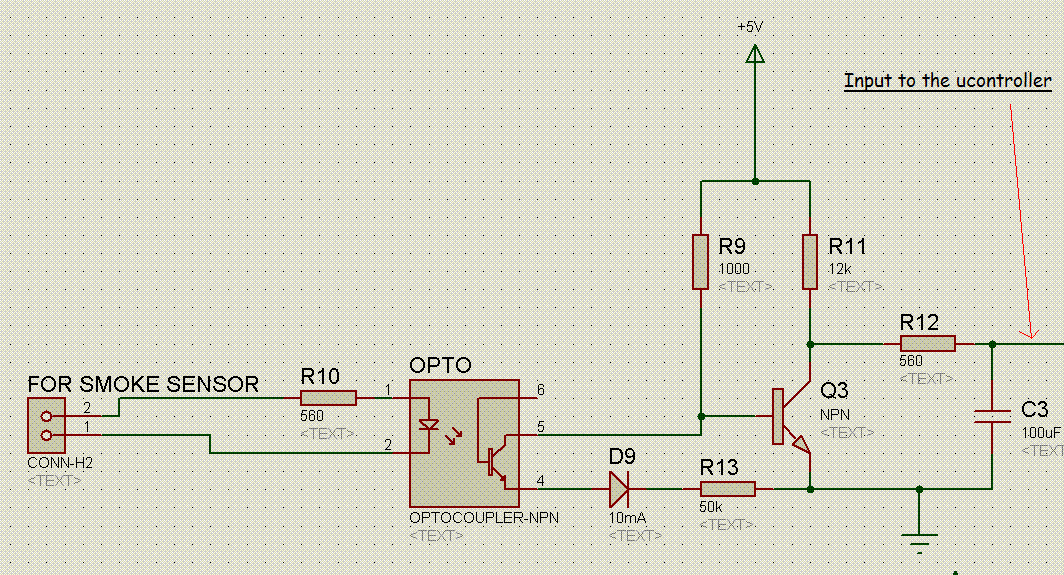

can you look at this diagram and tell me if tht is correct
i have also mentioned the Values.
Thanks :)

No, stick with Ove's original circuit. D9 makes it so your circuit won't work.
As Duffy said: The diode will make it impossible for the optocoupler to pull the base of second transistor all the way down to zero volt, the 50k resistor is also not needed in your design, however I understand that you want to invert the output, so it will be HIGH whe the smoke alarm is on. There is really no difference between a LOW and a HIGH when it comes to programming the PIC (its just BTFSS vs. BTFSC) - not any easier or harder. But you can invert the output, just have to recalculate the resistor values (now you need the cap to charge fast and to stay high a long time - with your/mine resistor values it charges slowly (bad) and goes low quickly (also bad)).
So what you guys are saying is tht i should remove the diode, keep the 50K resistor and the input to the micro controller would be high if smoke alarm is ON.
right ?
Loose the diode AND the resistor. Make R11 and R12 small so the cap charges quickly (with the current values it will never get the time to charge because the signal goes on and off all the time). You might get a problem making the ucontrolleer read the HIGH because the capacitor is less effective now, and you are running the risk of reading the port at a time when the cap is low although there is a signal from the smoke detector (when the optocoupler is off because current is being reversed between red and black wire).
