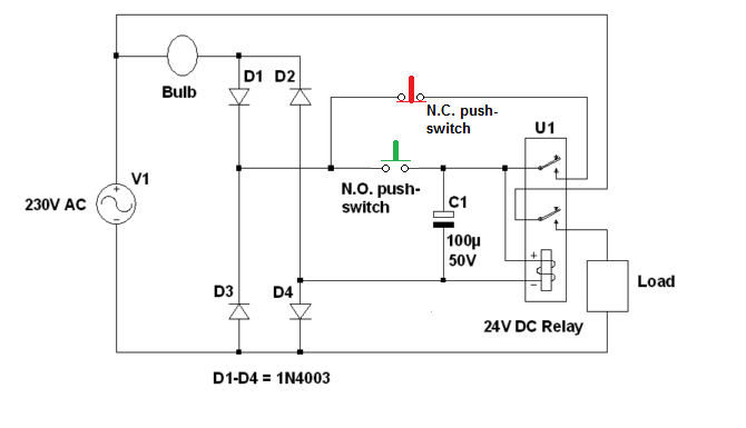

Need to make a dead mans switch
@Eric
The OP is trying to avoid using a mains-powered relay and wants to use a 24VDC type.
@Bigal_scorpio
I reckon a N/C switch in the relays coil line would do the trick nicely
It would. Or it could go in the relay's self-latching contact path as Eric mentions above.
What would be the maximum current available to the relay coil with the components shown?
The spec for the Schrack 805024 relay you mention says the coil resistance is 475 Ohms. So the coil current is ~50mA. That means the bulb current also will have to be ~50mA, correponding to an 11W bulb or thereabouts. Perhaps as found in a fridge, microwave, night-light, sewing-machine....?

Edit: A 100mA quick-blow mains-rated fuse in series with the bulb would be advisable, to protect the relay if the bulb should fail and arc over.
BTW, the wires going to the NC contacts of the relay aren't necessary (they were used in the simulation of the circuit and I forgot to remove them!)

Just another query, does it matter that the motor is induction?
This motor is a 1.4kW one that I have been given by a mates dad and I can't see any brushes but there is a huge starting cap on it, so I assume its an induction motor. Some relays seem to differ in the current they are rated at for resistive and induction loads. Is there anything I can do to help the contacts?
It matters in that the relay contacts are rated 25A for a resistive load and the spec doesn't give a rating for an inductive load. However, as your switched load is ~ 6A the relay may be ok.
here's a BORROWED, modified drawing of how to hook up your relay, You could add a 24 volt zener across relay coil or a resistor to load the bulb for a voltage divider.
There's no need to do that; the coil resistance already forms a voltage divider with the bulb resistance and the resulting voltage across the relay is....24V.
