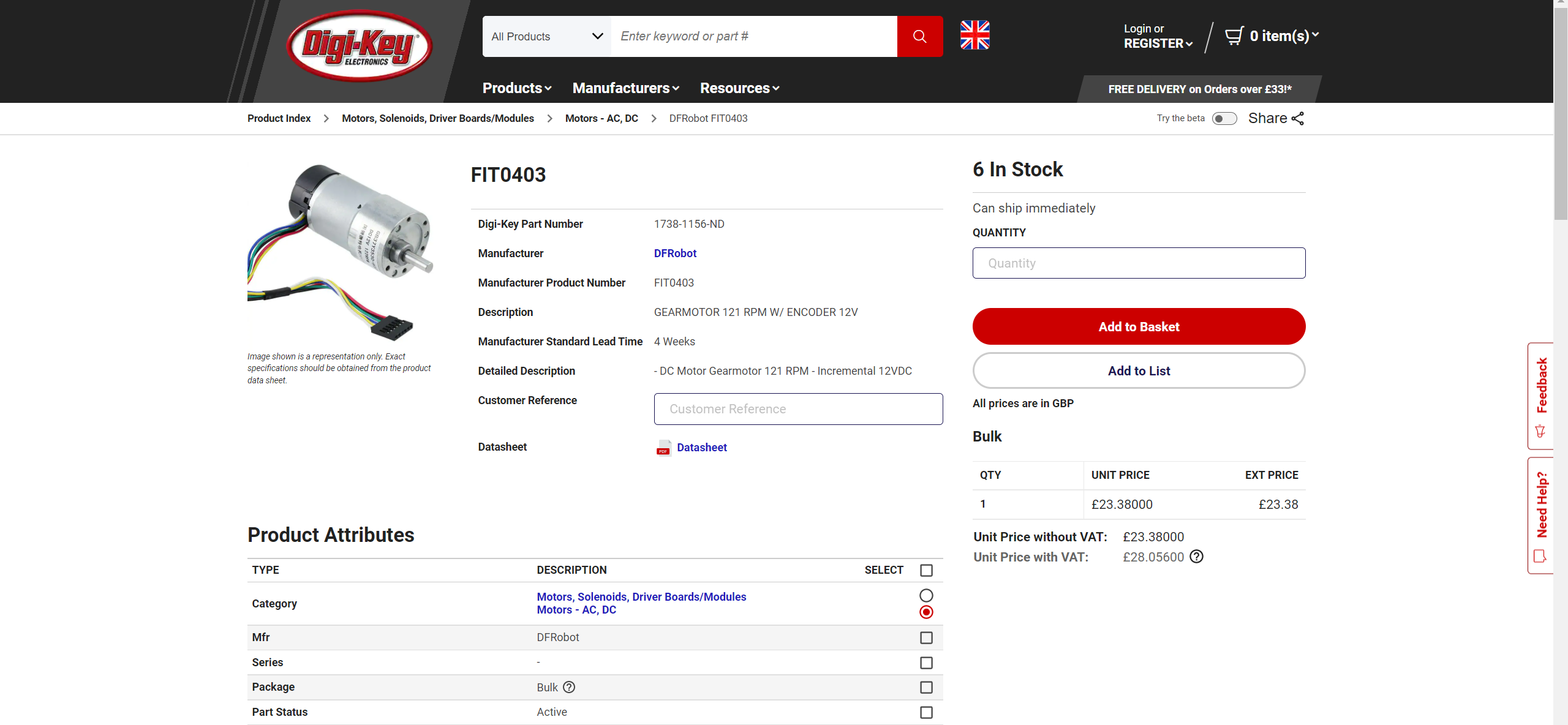

Hi, I'm based in the UK and am looking for a PMSM motor that comes with a controller ideally or that you can recommend a good controller for as soon as possible for a project I'm working on. As a backup I also would be open to looking at some basic DC motors as a substitute which would also be fine for what I'm looking for. Alibaba/any other chinese marketplaces is not an option as I need something available in the UK that can be shipped to me within days.
I want to write the code for the speed variation etc. for the motor using C code and an Arduino. Ideally, I'm looking for something in the price range of 50-70 pounds. The motor does not have to be particularly powerful at all, just a small and affordable motor- I am mainly looking to test the Arduino code implementation. For reference this is a motor I was looking at the issue with this one is that it from the datasheet it looks like it comes with the code pre-built in while I want to design the code myself. https://www.digikey.co.uk/en/produc...mylNahrgWW9e0vVbGK9xbO53QUYrPhtxoCIkAQAvD_BwE
That looks like just a DC motor and incremental encoder, what makes you think there is code includes?

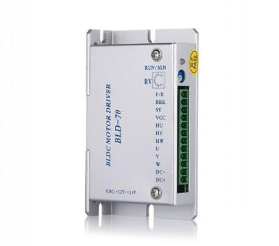

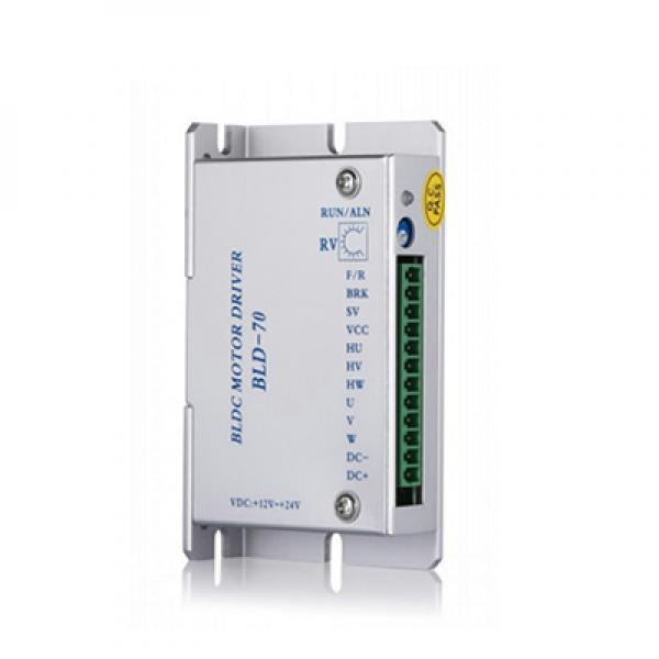

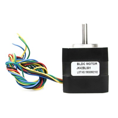

Also, if you are not directly driving the motor, a BLDC type with encoder would be cheaper and easier to source?
Drives to suit those are very cheap and readily available.
eg.
Info on that driver module here:

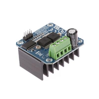

ps. The DF Robot one you link to is a basic brushed DC motor and the example code is to read the motor encoder for speed. It needs a separate power controller / H bridge such as this, which you could control with PWM from an MCU of some sort:
