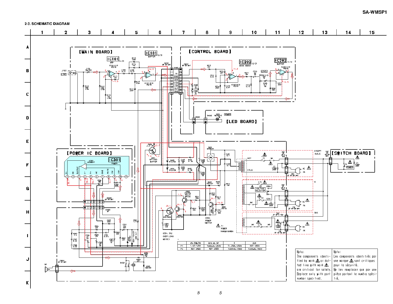

Hi I have been working on my sony sa-wmsp1 powered subwoofer for over a month now and I can't seem to find the problem. It has power but no sound. I have replaced the amp. # LM3886TF and still no good. Can you guys take a look at my Schematics and see what you can find and advise me Please.

It's a simple enough unit (although I couldn't read the PDF you posted), for a start have you checked the speaker? - it may be O/C.
Second, check the voltages on pins 1, 3 and 4 of the chip.
Third, does the relay click a few seconds after you turn it ON?.

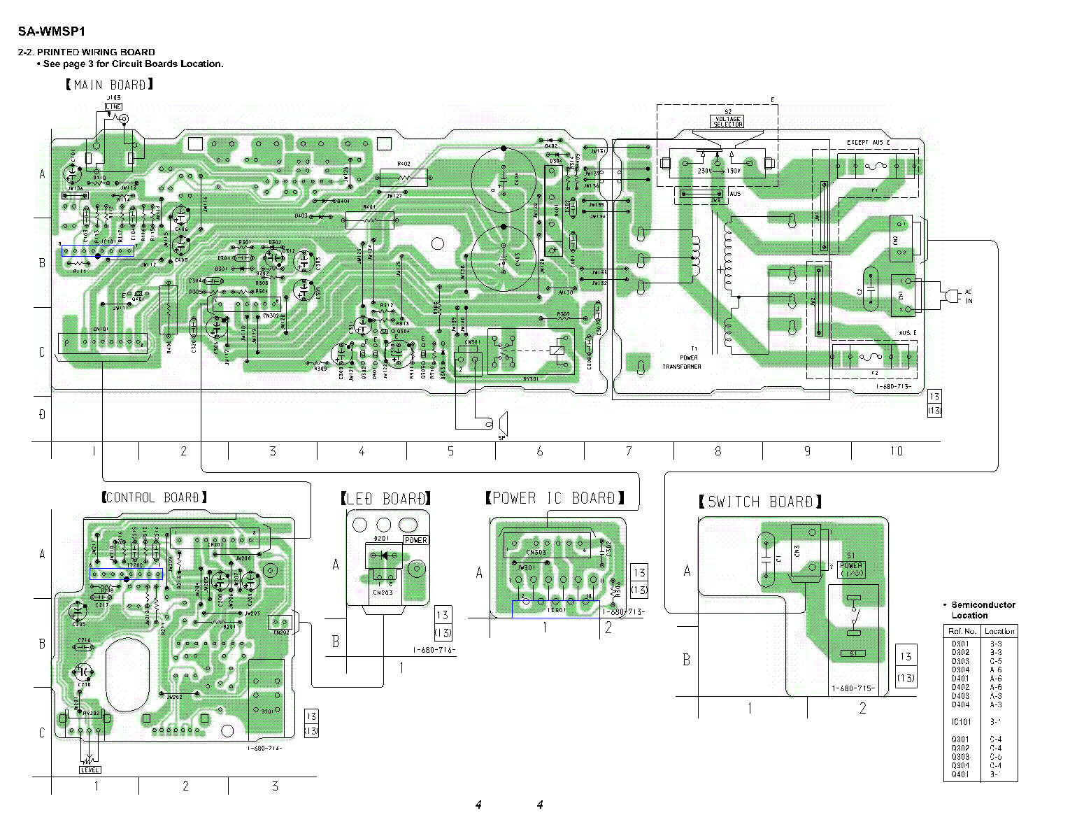

Here is the first page of the schematic
Pin 4 of the IC is its negative power supply pin. Since there is no voltage there then the wiring or bridge rectifier is blown.

Is there about -40V at the negative output terminal of the bridge rectifier?
If there is then follow it until it stops and you will find the problem. It looks like it goes through two connectors which might be loose.
Ok guys I have traced out the schematic and found that R401 and R402 are both getting the correct voltage in but are only putting out 3 volts also they are getting hotter than a firecracker. I also found that C101 is popped I even removed it to check it and still no continuity.
So what do you think.
The amp has many problems.
Capacitors are not supposed to have continuity.
Problems:
1) -40V is not getting to the amp IC.
2) The input capacitor popped.
3) The plus and minus 15V sources are overloaded by something.
Thank you for all of your help. I replaced the two resistors and the capacitor and the amp works fine now. This was a great learning experience and now I have the knowledge of tracing out this system.
