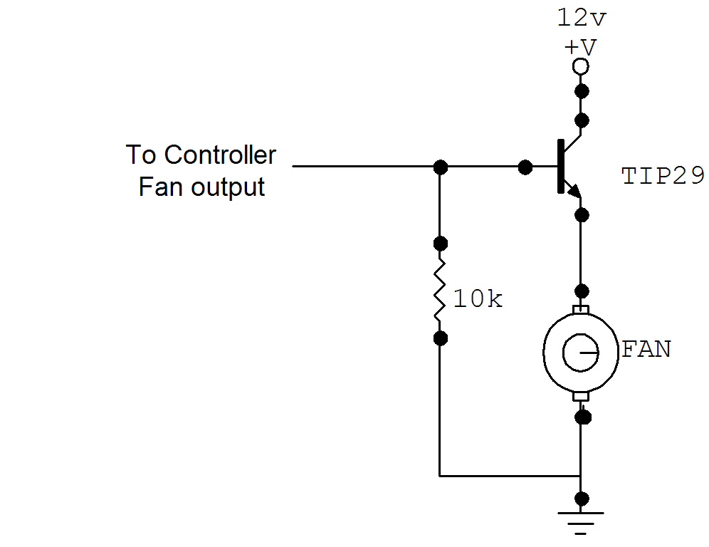

Now, I've got a very basic grasp of electronics, but I don't know a whole lot. What I would like to do is double the power going from the fan controller to the fan, which should let the fan controller use the fans to the maximum. From what I can tell, I would need to wire a transistor inbetween the fan controller and each fan. Is that right? If so, what kind of transistor would I need, and how would I hook it up (i.e. which pin would go to the controller, which pin would go to the fan, which wire would it go on - I'm assuming positive, and where does that third pin connect to)?

Does the fan controller control the speed of the fans, or does it turn them on/off completely as needed, or not needed? If it controls the speed of the fans, does it do so by turning them on/off at varying duty cycle, or by a variable DC voltage?
To achieve greater power to the fans, what it boils down to is that the controller's output to a fan instead controls an input to a circuit that uses full power from the computer to power the fan. The details of the circuit depend on the following:
1. The controller's output characteristics, as asked above.
2. The power supply voltage that will provided full power to the fans. I believe that is +12 Vdc.
3. The fan characteristics. I believe that is given in a link you provided.
I shall assume that the power supply is capable of delivering full power to the fans.
As for the battery, I agree with blueroom, that if a coin cell will last for 3 months, 2 AA cells will last for a lot longer, 2 C cells, much more longer. That is going to be easier than a charging circuit for rechargeable batteries.
Your relay idea to switch between computer power and battery could work with a capacitor to stand in for the time for the relay contact to switch from one position to the other. I assume the voltage from the computer is correct for powering whatever the battery feeds power to. If not, you will need a voltage regulator to drop the voltage to the proper level.
Fans are three wire. One sends RPM to the fan controller, one is ground, one is power. Fan controller controls the fan by adjusting the power (less power, slower speed). The fan controller is separate from everything else in the computer, it only receives power from the power supply (no motherboard or peripheral interactions, fans are powered from the fan controller and are not connected to anything else). I am assuming that if I double the power output going to each fan the fan controller will still be able to compensate (thanks to being able to read the RPM), only problem being that the fans need twice the power the controller can supply (hence the need to double the power).
The computer has 5v and 12v on all molex connectors, I was planning on using a resistor (or a few) to drop the 5v down to 3v. And hopefully it wouldn't fry the fan controller. It may be easier to just wire up a charge indicator to flash when the battery gets low, there are plenty of diagrams for that online.
It's still important to know why the controller only delivers 4 watts to each fan. Computer fan speed is usually adjusted by switching 12v power to the fan on and off at a variable duty cycle. It seems to me that a controller design would naturally use the computer's power supply to directly to provide power for the fans, anyway. Is it that the duty cycle never gets to continuous on at +12V, or is it that the controller cannot output +12V at .6A (i.e. the voltage drops below +12V)? Is it that the maximum RPM of the fan is limited, no matter what fan you use? If you have a voltmeter you can measure the DC voltage at the fan to help answer that question with the fan and its probe physically separated from each other and the controller temp adjusted to minimum for that probe so that the controller will output full power to the fan. The temperature of the probe should be made to be above the set temperature by warming it, if necessary. You can then see if the voltage is a full +12V, or some other voltage. Do this with a .3A fan (or smaller) as well, and see if there is a difference in the voltage at the fan. There is a reason the controller only outputs 4 watts and it may have nothing to do with limitations on the capacity of the power supply.

You can try the attached circuit to boost the current output of the controller. Depending on the controller's output, you may not need the 10K resistor.
I can't hurt to try it, but I can't guarantee it will work. The controller output may not be a voltage. The controller output may be a FET with source connected to ground and drain connected to the low side of the fan, requiring the other side of the fan to be connected to +12V. Or, something else. There's just not enough info on the controller output to know. It would help to know if one the pins on the connector that mates to the fan always has a solid +12 volts on it (and I mean solid, because the tach output might be pulled up to +12V, which is not solid). If it is a FET pulling the low side of the fan toward ground, then you will need a different booster circuit configuration. Get a TIP30 transistor while you are at it, to cover that possibility. Maybe you can write down the part number from an IC that's involved in the output to the fan. I'm sorta shootin in the dark here.
