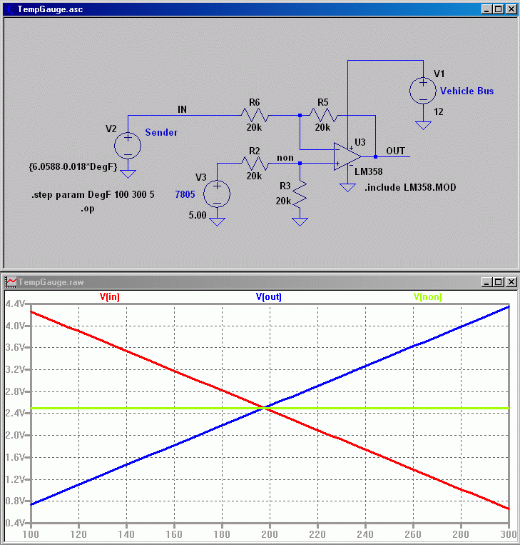

Here you go: Ain't LTSpice wonderful? You want a voltage to change as a function of a parameter like DegF, here is how you do it...

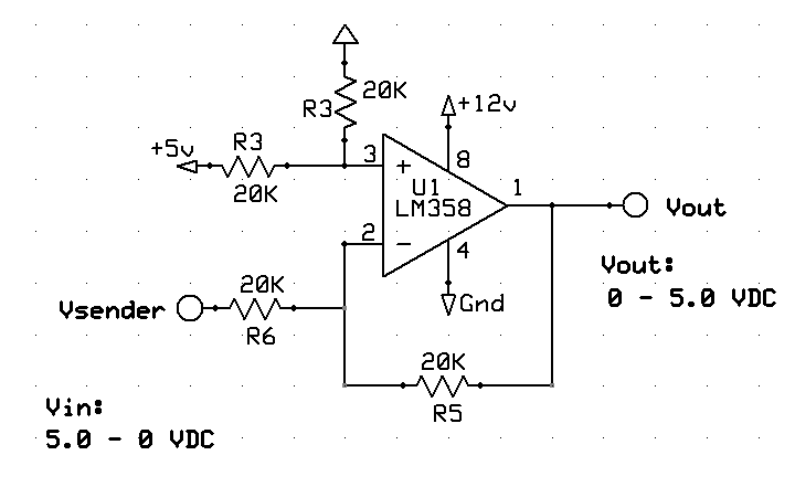

Cool - I'm not familiar with Spice - most of my engineering is materials and quality/statistics related - these little projects give me something to do when it gets cold here.
Here's my revised schematic (copied yours :) )
