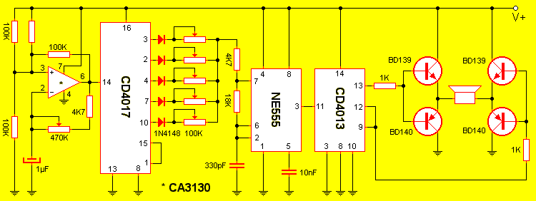

You can use the next circuit. Must adjust the pots in different sets. this circuit must generated a 5 differente frec below 22 khz. If you have a pet may be need a retouch on the pots. The circuit was generated by the site www.pablin.com.ar unfortenaly this site over spanish but you can find help anywhere.
