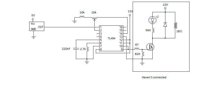

Hi there people. I'm currently doing a project to make a levitating system with the use of an electromagnet and a control circuit to vary the current in the electromagnet, thus getting the object to levitate. The sensor I'm using is UGN3503 hall effect sensor, and this measures the change in magnetic flux and gives and output voltage proportional to the change. This is fed into the TL494 chip, which then gives a PWM signal based on the error amplifier. This signal then goes to a power mosfet, which turns the electromagnet on and off.
Here's what I've done:
Pin 1 - Hall effect output
Pin 2 - Reference voltage
Pin 3 - Left it open
Pin 4 - Left it open
Pin 5 - 220 nF Capacitor
Pin 6 - 2.7k Resistor
Pin 7 - Ground
Pin 8 - 12V supply
Pin 9 - Gate pin of a power mosfet
Pin 10 - Shorted to 9
Pin 11 - 12V supply
Pin 12 - 12V supply
Pin 13 - Ground
Pin 14 - Into pin 2
Pin 15 - Left it open
Pin 16 - Left it open
I am failing to get any PWM signals at all, what have I done wrong?

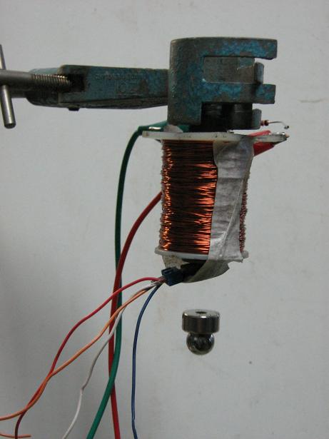

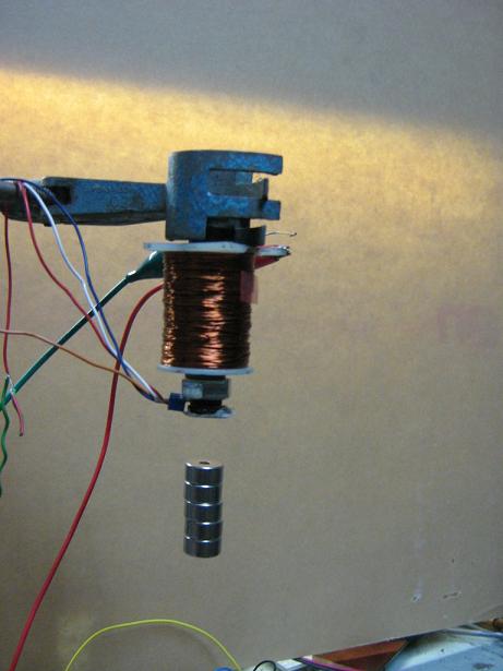

Funny enough i just built one for the hell of it, and after a few trials of methods its working fine.
First i tried using a micro, but that worked although it proved too slow in adjusting the coil on/off, so back to basics and used an op-amp, this works very well.
My recommendation to you is to scrap half the junk you have and go simple as i did, it works.

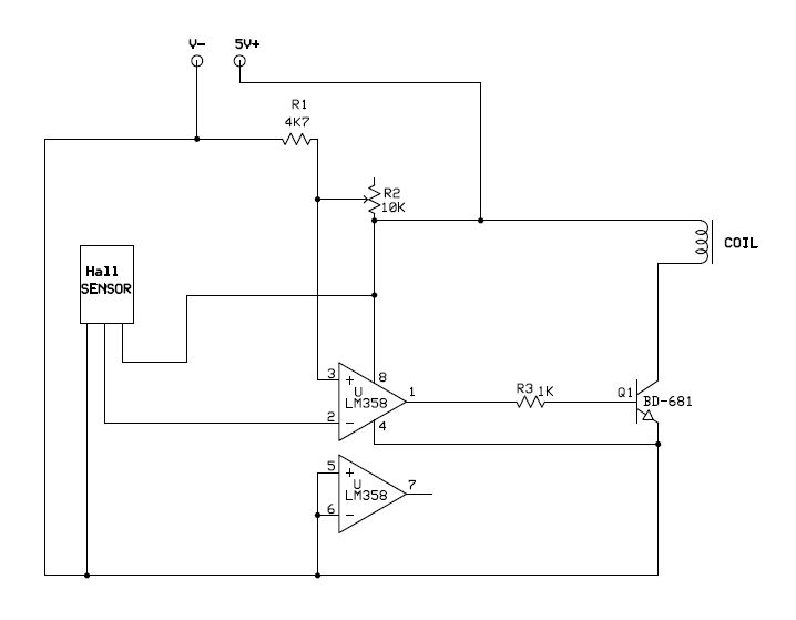

I used a LM-358 op-amp (or 1/2 of it) the non inverting input has a pot set as a voltage divider on it so the threshold can be adjusted, the output from the hall sensor is fed into the inverting input of the op-amp, the output of the op-amp supplies the base of a BD681 transistor via a 1k resistor, the transistor drives the coil.
All very simple and the circuit operates off 5 volts, dead easy and works well.
Excuse the rough setup in the photos as this was just proof of concept
Pete.
Are you using a power transistor?
I think that just might be the prime component that was required for my circuit to work.
The transistor is a darlington rated to 4 amps but the circuit draws less than 100mA in my case.
Here is the schematic for the circuit i done...........
Pete.

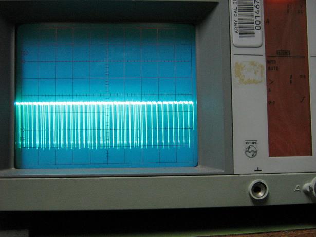

For anyone interested the wave form of the circuit with a magnet in levitation is as per the photo below, the volts is set to 1v/cm and 1mS/cm.
No emf diode used.
Pete.
Nice! Thanks for the scope trace. It looks to be running a fraction over 3kHz once it settles down. Is that trace the output of the LM358?
I'd be tempted to put a cap in there somewhere and get it to oscillate a little slower and more stable.

Lurkingdevil - I haven't actually put my transistor into the circuit yet, but I thought that would have been unnecessary for the output pin of the PWM chip to actually give an output at all.
Pete - Ok that's awesome, I'm guessing you've used a UGN3503 Hall Effect? I might give that a go too just to show the principle of levitation, but for future studies I would still like to try a PWM, and possibly a programmable microcontroller as well. Anyway here is the schematic I'm using, and the boxed part is the part I haven't connected yet. I'm just testing the output pin 9 & 10 compared to ground, but I never seem to get a PWM no matter what I do to the input voltage at pin 1. Any ideas why?
The pot. going into pin 2 is for height control, trying to levitate it at different distances from the electromagnet.

The trace was from the output of the LM-358, and the hall sensor was a UGN3503U, but i think any linear hall sensor should work.
I dont see why you have a led across the coil as at 3khz do you think you will see it flash??????
I think the supply voltage might be too high as the coil will be too powerfull, requiring the magnet to be further away, then you have the problem of the magnet being too far away from the hall sensor to read, so you endup in a loop of things not working, try 5 volt supply.

The LED was placed just to make sure current was passing through it, which didn't happen so I knew something wasn't working.

Are you aware the hall sensor must be faced the correct way to the coil, in my case the flat side (or back) of the hall sensor faces the coil.
With a 5 volt supply to the hall sensor, the sensor output should be somewhere around 2.5 volts, and as you bring a magnet towards the sensor the output voltage should increase, it might pay for you to check this with a meter.
It is also important which way the coil is connected so the right magnetic polarity is created for the hall sensor, if the coil wiring is reversed than the sensor will decrease in its output voltage when the magnet is moved near the sensor.
I have had not very good results with using a metal object in place of the magnet as the change in field strength is too weak for the hall sensor and the object gets too close to the coil.

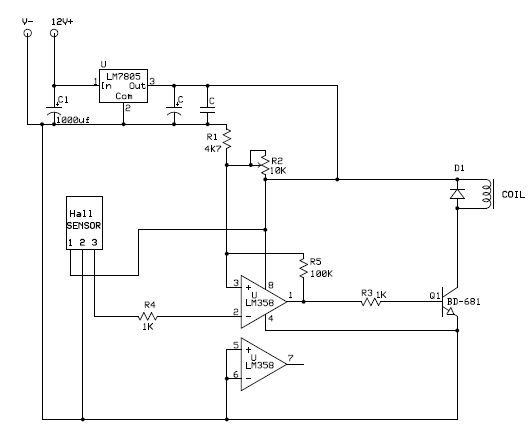

4k7 is a standard way of writing a resistor value and means the same as 4.7k
I had a chance to play with the circuit a little more and found the magnet can get the wobbles up and then becomes more insensate as the wobbles increase, to the point the magnet moves outside the sensor area and falls off.
By adding some feed back to the opamp helps reduce this effect.
I added 100:1 feed back, see schematic for R4 and R5, also added a 5 volt regulator and a diode across the coil to the schematic.
I have since changed the circuit even further and have added a 08M picaxe to my board, the only function the picaxe do is to monitor the output of the opamp for pulses and if no pulses are detected in 50ms it turns the coil off.
The reason for this is at times the magnet can wobble and fall out of levitation, and without the magnet near the sensor the coil switches full on, drawing a lot of current and over heats the voltage reg, the addition of the picaxe solves this.
It also allows for a lower resistance coil to be used as it is no longer limited by the voltage reg, as when the circuit is operating with PWM to the coil it draws 50-100ma, but without PWM it can go as high as 1-2 amps, the reg can handle this for 50ms.
When i have time i will draw up the schematic for the revised picaxe circuit also.
Pete.
