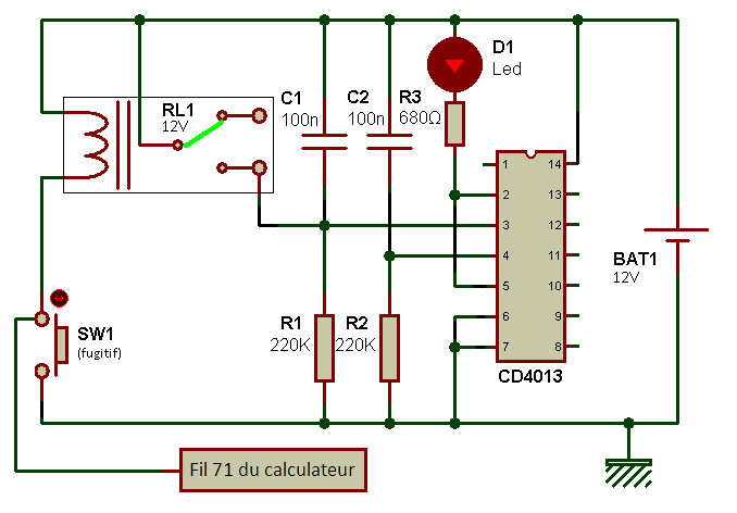

Just ran into this, https://www.hptuners.com/forum/showthread.php?8887-Performance-Mode-Switch-Option/page5
There are 5 pages (that started in2006) devoted to the solution I'm looking for and a frenchman seems to have come up with something but it gets pretty quiet after that. KISS I think you and Alec are going down a similar path, what do you think? Just more food for thought, if you're still hungry!
what do you think?
I think the French circuit (a) risks damaging the ECU because SW1 is switching a relay coil without a back-emf suppression diode, (b) the relay is totally unnecessary anyway and (c) pins 8-11 have been left floating, so the IC may behave erratically.
What Alec said. I think they are trying to use the relay to debounce, but the relay contacts itself will bounce. It's 12 V totally, and that's what we're waiting on confirmation for. I'm asking for the one or two diode drops just to see if the logic levels are CMOS which means that the switch ground has to really really be close to zero volts.
In the circuit above, the pushbutton turns on the relay as long as you hold it down. What's the point of that?
If you watch the video in the thread its doing exactly what we are after. I am going after parts soon and will get the info you guys are after. I just think its interesting that this same common silly little problem has been an issue since at least 2006!
Sorry, I'm not convinced by a video of a LED going on/off. It tells us nothing about the possible problems with that circuit.

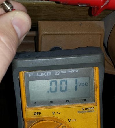

Ok guys, I went out and did a little checking, it is a 12 volt source. These were taken with the engine running and in drive.
Haven't ran in to radio shack yet but I got to thinking about this in regards to the diode test: Check if in both cases the tow package toggles
I have an axle out right now and can't actually drive to feel the difference in shifting mode, do you still want me to go through this or does it need to wait?
Just to confirm, are those the wire 71 voltages with and without the button pressed, respectively?
The diode tests are less important than knowing the open circuit voltage is 12 V.
