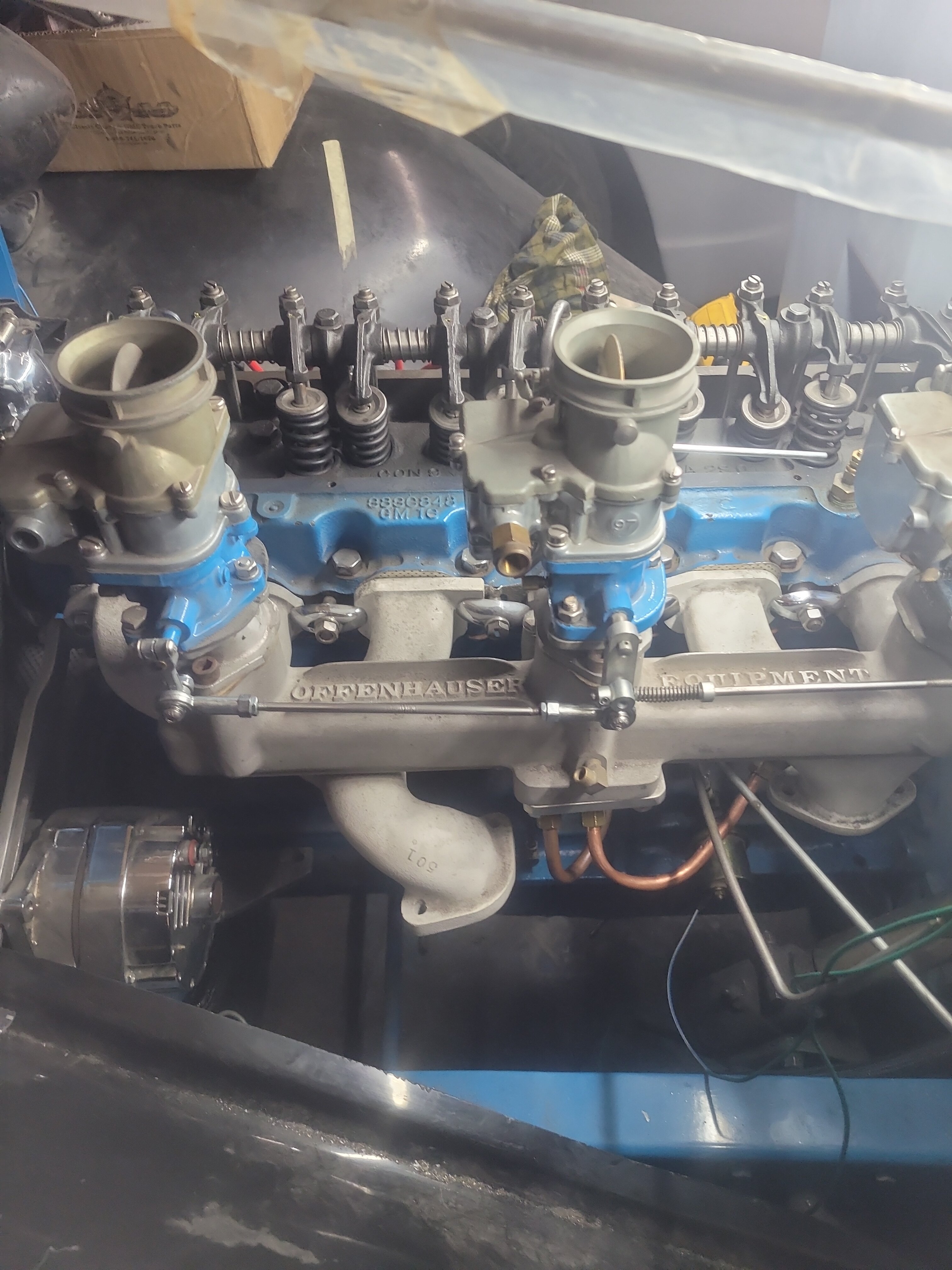

I am building a 1936 Chevrolet pickup and it has a 261ci straight six with 3x2 Stromberg carburetors and I am installing an inline fuel pump and my dilemma is that the pump just keeps pumping when I have just the key on and so therefore it just keeps filling the bowls and intern just keeps dumping fuel into the engine which is obviously not safe for one but not good for the engine, so I'm trying to figure out a way to design or if it already has been done, a auto shutoff switch which works when it reaches 3 to 5 psi, like most modern vehicles there's are ran from the ecu, well this one definitely doesn't have one so yeah if anyone could help me out or point me in the right direction it will be much appreciated

This article says your fuel pump shouldn't exceed 2.5psi on the Stromberg 97 (yours).
Even turning down the pumping rate doesn't turn down the maximum pressure you get - it only takes longer to reach max pressure. I'd start with swapping out your fuel pump. Make sure it can meet the volume/minute needed at full power but not exceed pressure to overpower your check valves in the float.

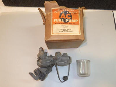

You must have the correct type of low pressure, diaphragm and spring pump - either the correct (from what I can find) AC type 421 mechanical pump for the 1936 engine, or an SU electric style as Diver linked in post #2.
The originals do appear occasionally, eg.

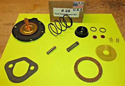

Rebuild kits are readily available if you find an old one.
You need the new diaphragm as the originals are rotted by ethanol on modern fuel.

Those are mechanical fuel pumps. They have the advantage of not needing electricity and no danger of feeding fuel if the engine isn't running. However they won't prime if there is no fuel in the carburettors unless the engine is cranked for a long time, and you can get vapour lock problems by having the suction side in a hot area, and obviously there has to be provision on the engine for the fuel pump, where its lever is usually operated by an eccentric on the camshaft.
The diaphragm in the rebuild kit for the mechanical pump is similar to the diaphragm in the electric fuel pump that I linked to before.
