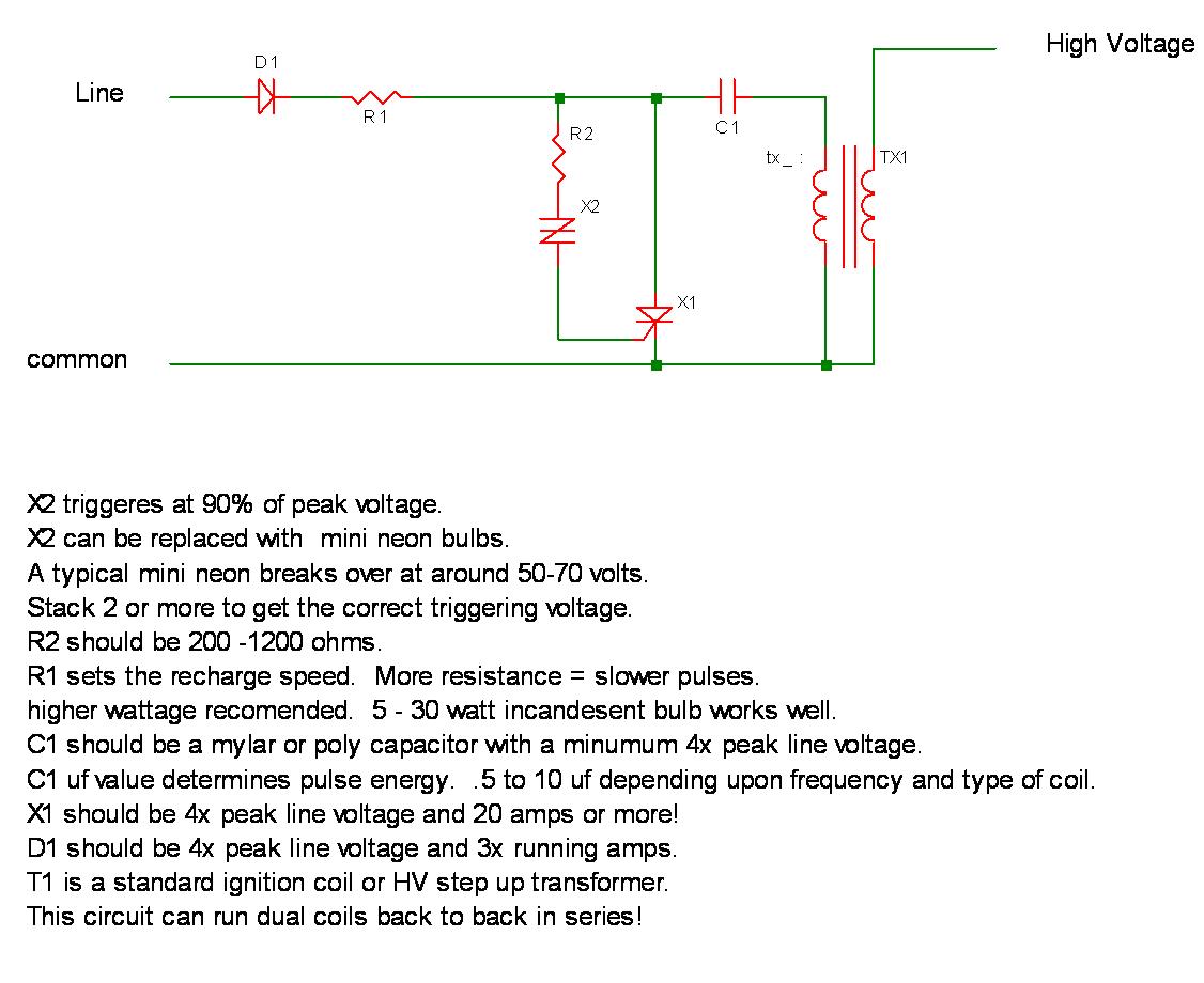

I recently come across a few old ignition coil lying around the house, so I decide to build a driver to use it to make arcs and etc. I started with the 555 based ones but obviously they are not giving enough power, so I moved on to off the line drivers, but my problem is that my SCR based design can only operate at line frenquency of 50Hz. which is to low to excite the coils fully. Can anyone offer me some sort of advice as to how to alter the frequency of an off the line ignition coil driver. or maybe a complete new design of a off the line ignition coil driver. Much appreciated.

What frequency are you looking for? and one quick question, what's the DC resistance of your primary coil?
I have no idea, I do not have the equipment to work out the resonance frenquency, I am hoping for one that can tune from 50Hz to maybe 1 or 2 KHz. the dc resistance is about 4 ohms.
It's a ~100:1 turns ratio with ~20kV on the secondary depending on the size of the gap it's powering, so you might just use a step-down xformer or dropping resistor from the 230vac., but the coil is not designed for continuous use.
Don't run the coil with the sec. open-circuited, it overstresses the insulation.
I am using a fat incendiary light bulb as a ballast, it should pump too much current through the primary. and the hole setup is in a fish tank with oil, but the main thing is that at 50Hz the arc (spark) is pathetic. When I use a 555 based driver at higher frequency then the arc is juicy and hot, but I cant get enough power. As I said earlier I am looking for one that runs off the line and have a higher frequency.
If the primary coil is 4 ohms couldn't you feed it from a power audio amp?
provide if I have a old audio amp. The thing is no one would give a 17 year old guy in South Africa an old amp to play with, not even my parents and the other thing is people don't throw away things here. sorry man, Id look into it but don't think it would solve the problem.
I still prefer the SCR based capacitor discharging driver. My thing is that The SCR cant switch it off automatically so I have to syn it with mains. I just checked that PowerLab claimed that They have got a SCR based off the line driver that can operate at 6kHz. However they offered no detail of the circuit. What a pity.

Seems to me your images are a good way to go. Why not try them? In a), you can switch the gate of the SCR with a 555 timer substituting for the switching of the 12 VDC. You can do that switching at a rate in the KHz, while still powering off the mains. The SCR will not stay stuck-on because the counter EMF from the coil will turn it off. In any case, a TRIAC could be used instead.

That might actually work. but then I tried it on a simulator (MultiSim) it failed. Isn't that because the counter EMF is only generate when the current in the coil is interrupted when the SCR or TRIAC turns off? So one need to turn off the SCR to turn it off, if you know what I mean.

Your reasoning is sound. But, the secondary field will collapse, after the capacitor is discharged, which gets reflected back to the primary. This effect might not be included in your simulation.

Ha Eureka, never thought of that. You are a star.
Here is an actual Line voltage driven CD type ignition coild driver circuit.
This circuit is very adaptible and forgiving.
