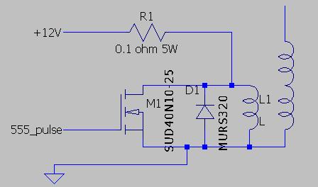

Need Help with off the line Ignition coil driver.
actually, more like this..... this gives a better ground reference for the secondary
the parts can be any mosfet with a high current rating and the diode can be any 3 amp or higher type, preferably a fast recovery type.

Here is an actual Line voltage driven CD type ignition coild driver circuit.
This circuit is very adaptible and forgiving.
Nice design. What exactly is X2? and why is everything suppose to be 4X peak voltage. that is 300X4=1200V, things at that type of rating is quite expensive. Will 600V be fine? and what exactly does 2 coil connected in series mean? - or coil A to + of coil B? can I use full wave rectification and a smoothing Cap on it? or maybe 2 coil in anti parallel.
Sorry I did not label X2 its a diac or it can be a better quaity MOV with a good breakover voltage.
It can also be 1 or more mini noen glow bulbs in series. They have an additive breakover voltage,
Basicaly its just any device that will go from nonconducting to conducting at a specific voltage.
Two coils in reverse series is where you put the power in the + of one then connect - to - and take the power out the + on the second one.
Being the two coils are being driven 180 degrees out of phase from each other you get a much higher voltage differerntial at the HV outputs.

Being this is a highly inductive circuit you need the high voltage ratings to get any decent life out of it.
600 volt should work but it could still go give you problems when you draw the high voltage arcs out to a long lengh. Try it and find out!
A 1200v Scr is only a few dollars at digikey or any other online electronics parts supplier. Same with High voltage capacitors and diodes. If you know where to look this is a under $25 circuit to build. $50 if you need to buy the coils new.
But any ignition coil will work with this circuit. Even ones off lawn mowers! ;)

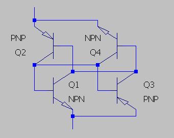

for X2, I know that MOV, and neon bulb would work but for DIAC? its DIAC suppose to be like breakdown at a specific voltage?

or you can do a "roll your own" diac.... like so..... just use complementary transistors

X2 it's been years since i built a diac using transistors, so i don't remember how to adjust the breakover voltage..... oops, i drew it wrong.... the collectors are connected to the bases and the emitters are at the ends..... like this
and that's actually a Shockley diode (not Schottky). you make a diac by wiring 2 of these together parallel and reversed.

A Diac "snaps" over, an MOV doesn't. You need the snap action to get the e=-L (dI/dT) effect.
the SCR equivalent would be the same device with the trigger input on one of the B-C connections. other than that, they are the same device. the diac is like 2 of these devices back to back and all if the internal p regions wired together and all of the internal n regions wired together (which makes me think i got the internal bridging between the shockley devices backwards..oops again....).). interesting silicon equivalent of a gas discharge tube, and SCR's are a silicon implementation of a thyratron tube (gas discharge tube with a trigger electrode). i've seen pictures of BIG SCR's rated at almost 1900A that are 3" diameter. they replace thyratrons and ignitrons that were the size of a refridgerator.
