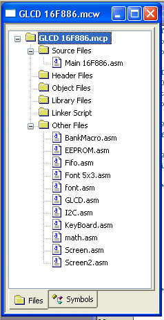

Try changing #include <CM-BANK.inc> to include "CM-BANK.inc" so it looks in the project directory.
I just noticed your macro has include etc. in it. Delete the first 4 lines of the macro file so that the first non blank line is the macro code. Make sure you save the file in the same folder as the project file and it should work.
Hve you saved the macro file as "CM-BANK.ASM" or as "CM-BANK.INC" ? As your code is looking for a file with the .inc ending and you mention just saving it as a normal asm which I assume uses just the normal .asm file ending attribute. If so it wont of course find it.
Hi there,
I tired removing those include etc. from macro code but then the hex file couldn't be generated (shows that no configuration set, though the build was successful ), so I again add those include and etc.(first 4 line of macro code) then the massage that config. is not set had gone but the hex format shows all 3fff (blank):confused::confused:
The macro file should not be in your project as a source file but as a other type file.
Here is one of my projects showing where the additional files should be,
Hi Mike,
It still not working, check the code of macro file saved as .ASM........
Bankx macro	var
	if(var==0)
	  bcf STATUS,RP0
	  bcf STATUS,RP1
	endif
	if(var==1)
	  bsf STATUS,RP0
	  bcf STATUS,RP1
	endif
	endm
	end

I ADDED CM-BANK to other files both macro and the program gets build successfully but when the hex file loaded in the PICKit 2 programmer it show int it's window.............
Warning: No configuration in the hex file
and reads all 3fff:confused:
You somehow are not assembling your main file. Get a project that works and produces a hex file and then include the macro file.
Hmm....., though I have had it tried already with a working project still I'll try it with another working project, b.t.w. I just notice that I'm making the macro in 16f690 template, is that a problem? I'm trying writing in a New blank file and not in any template, will let you know, Thanks for your time.
