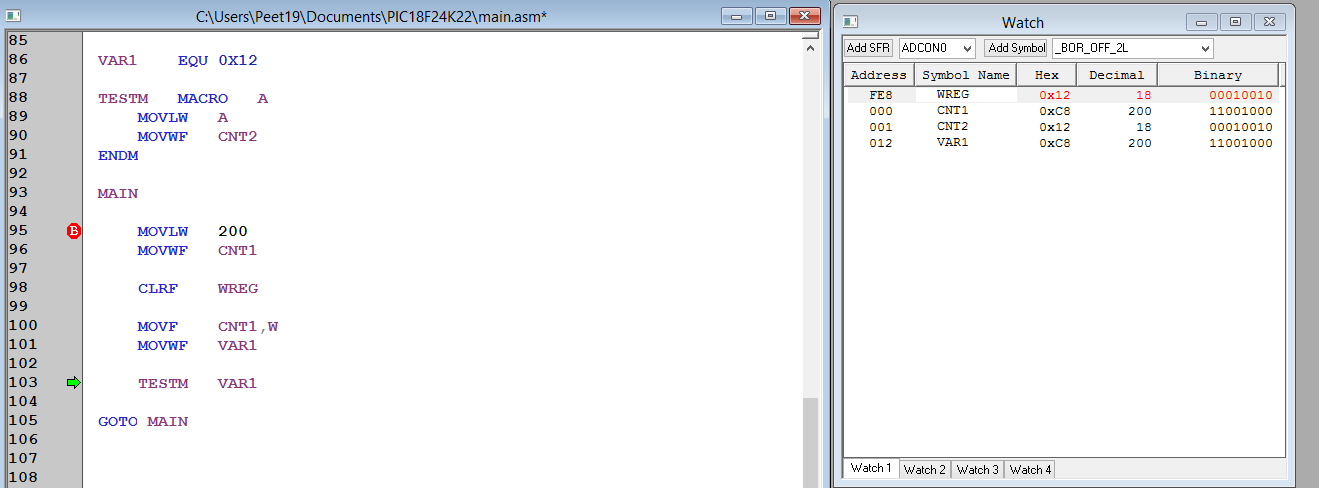

Hello!
I want to pass the value of a register to a macro, but I don't know.
How can this be solved?
 MOVLW 100
MOVWF XY
LOOP
MOVLW 10
SUBWF XY
VAR1 SET XY
BEIR VAR1
GOTO LOOP
I decreased the value of the XY register by 10 in each cycle.
If I enter the name of the register as a parameter of the macro, it does not pass the value.
I already tried changing the value of XY to a variable and passing it when calling the macro, but that's no good either.
What could be the problem?
Here is the macro:
Mist:
BEIR MACRO A
MOVLW A
MOVWF ZZ
ENDM
But if I enter a number when calling the macro it works.
I don't understand the problem.
Thank you in advance for your help!
If someone could tell me how to load the value of a register into a variable, I would really appreciate it.
Eg: VAR1 SET XY
it only loads the address of the register into the variable, not its value.
I just need the value, it would solve my problem.
Thank you very much in advance.
Eg: VAR1 SET XY

I did a simple test, but it's still not good.
85 will be in VAR1 and 200 will not be included.
In other words, I give the macro 85, not 200.
I do not understand.
All I need to do is load the value of a register into a variable that I can pass to the macro when the macro is called.
VAR1 EQU 85
TESTM MACRO A
MOVLW A
ENDM
MAIN
MOVLW 200
MOVWF CNT1
CLRF WREG
MOVF CNT1, W
MOVWF VAR1
TESTM VAR1
GOTO MAIN

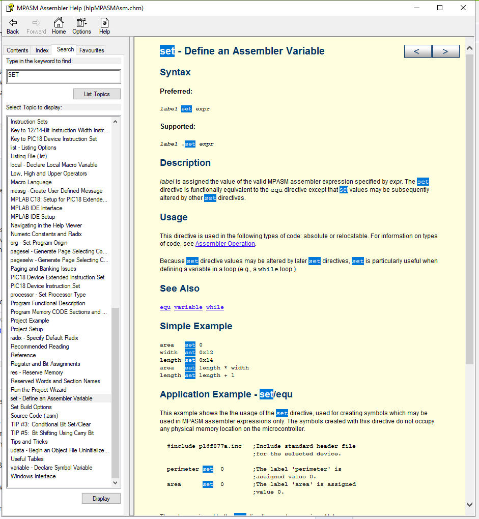

There is no 'set' instruction in mid-range assembler, what device are you using?.
Really? From MPASM 8.92 help file.
Fails.
VAR1   EQU   85
TESTM   MACRO   A
MOVLW    A
ENDM
MAIN
MOVLW   200
MOVWF   CNT1
CLRF   WREG
MOVF   CNT1, W
MOVWF    VAR1
TESTM   VAR1
GOTO   MAIN
MOVLW means MOVe Literal to W - so will move the value 'A' (0x41) to W, and the variable A isn't used at all.
If you're posting code, put it in the 'code' quotes, as I've done above.
Something is very wrong.
Check out.
When I call the macro, the address of the parameter is passed, not the value of VAR1.
The rest works fine, but this one is not good.
I would like to be able to send the value of VAR1 to the macro.
If I understand correctly, it is not possible to pass a parameter to the macro that is variable?
Check out.
See post #17, you're still using MOVLW to pass a fixed value (0x41) in line 89 - look up MOVF
