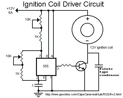

The Res/Cap and the power zener should clamp the 2N3055 collector voltage to a level suitable for the 2N3055. Dont forget the ballast resistor.
Keep the pulse drive width as short as possible for a consistant spark.

I made one years ago using a NPN power transistor (before I knew about MOSFETs). It was making weak sparks until I added the ignition condenser like it would be in a points type ignition. It worked great with long blue sparks and the transistor didn’t get hot. My problem was that it petered out before the 20 KHz that I wanted. (not enough dwell time)

Try this circuit. It generates short pulses the same way as used for cattle fences. The pulse widths are selectable 14.5, 24.0 and 31ms.
However there is a small disadvantage to the circuit. If the timer IC quits working and remains on high output state it will fry the power MosFet since the ignition coil will saturate and finally make a dead short. To avoid frying of the transistor I strongly recommend the fuse as drawn in the schematic. If for some reason you can't obtain a capacitor of 220n/630V you may select a 470n/630V type. In that cas R1 has to be changed to 8K2 and R2/R3 to 4K7.
If the pulses repeat too slowly short R5.
Remark: That device works with electronic ignition system coils only!
Sorry the wiring error, here is the corrected circuit.
