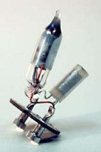

so, I have this fluorescent night light and I use it for the garage late at night, anyway, it burned out and the parts inside look ok. Except for this second "mini" lightbulb inside. (It looks all blackened. The nightlight says mini fluorescent A.P.P. on it.
I could use help finding both of the bulbs, (the mini one inside, and the fluorescent bulb (also inside))
Could the mini incandescent bulb be used as a fuse.
Thanks in advance, Ray
Does the "mini" one look like something like this:
If so, that is the starter.
