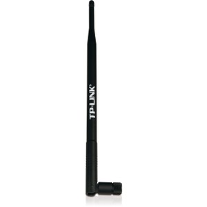

So this little guy came in the mail today. I hooked it up to the existing antenna jack... the one i wired into the two holes on the bluetooth module. I have to say that i'm impressed with how well it works as-is. I'm currently in my basement typing this with my phone in my pocket that is playing music on the kegamp, which is upstairs in the kitchen. I haven't done any kind of distance test yet (it's too cold!), but it's already working better than what i thought my best case scenario would be. I'm basing that on other people's bluetooth speakers that i've used over the years. I'm really curious what you think the expected range would be if i had done things properly in the way you described, and with an antenna with a higher dBi.
The antenna:
OK, well, that's a nice little antenna, but why did you buy a right-angle style? My intention, when I suggested it before, was that it stick out the side of the keg in line with the connector, not at right angles to it. This was for electrical and cosmetic reasons. The electrical reason is a bit complicated, and there are two main factors. One is that, since this is a monopole antenna, it needs a ground plane to work optimally and the ground plane must be at right angles to the whip (ie. across its bottom). Also, as we are working at a very high frequency, the distance from the base of the black part to the ground plane should be minimized. These things affect both the impedance matching (discussed below) and the radiation pattern.
Polarization is also a factor, where the sending antenna should be the same orientation as the receiving antenna. At 2.4GHz indoors this is not critical because we expect a considerable amount of polarization scattering due to multipath reflections. Also, the access point antennas are usually very flexible on how they are oriented which compensates for the lack of flexibility in the client device (ie, your speaker). The right angle antenna is actually polarized ok.
However, this antenna is presenting an unknown impedance due to the very close proximity of the reflecting metal keg, which appears to be about a quarter wavelength away, and also due to the long distance between the base of the antenna (the black part) and the ground plane (the keg). We antenna folks fuss about impedance a lot because it is one of the key things that contributes to how effective an antenna is. We seek "maximum power transfer" in both receiving and transmitting directions. Matching impedances from source (the transceiver), through transmission line (the coax) to load (the antenna) ensures that power is not wasted, it gives us maximum power transfer and minimum loss of power. Impedance matching is important because mis-matching costs you power, and power directly leads to range, and we all like a lot of range.
The coax cable you use has a characteristic impedance of 50 ohms, and you need your antenna to also have an impedance of 50 ohms, which is what I mean by impedance matching. In order for your monopole antenna to have an impedance close to 50 ohms, you have to provide it with a ground plane that is in the correct position and orientation. In this case you have not. As a result, you may be wasting anywhere from 0 to 10 dB. Its hard to say exactly how much.
Now, you could say that I'm obsessing over details and that the way you have it now should work adequately well, even if it is not optimal. That's true. But from a looks point of view, I think this is only a partial improvement over what you had before. You can stick with this if it looks ok to you, but it could be better. Its hard for me to argue for changes if you are happy with it.

Generally speaking a larger antenna is better. This antenna looks small. I have antennas for this frequency that are 2x and 4x and some much longer.
This antenna has a right angle. In this direction the antenna is probably too close to the "ground plane". Any large piece of metal. If the antenna stuck out to the right the ground plane would help, not hinder.
Well shoot, it sounds like i screwed up my choice. I chose the right angle one in an attempt to minimize how far it sticks out. I actually planned on putting another nut and washer on the connector inside of the keg to bring the antenna in another 1/8" or so. It sounds like that would be counterproductive though. Aesthetically i like the right angle better actually (except the polished brass part).

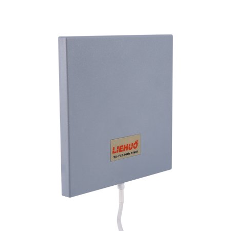

This antenna has 8db more output than what you are using.
This one has a gain of 14db. It needs to be pointed at the right direction. It will not care what it is mounted on.

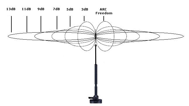

This is the pattern(s) for whip antenna(s). The short antenna you have is like the "ARC" pattern. As you can see, a 13db antenna needs to be pointed in the right direction.
A directional (high gain) antenna is like a flashlight. The energy is mostly pointed where you want it to go.
