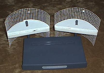

http://www.freeantennas.com/projects/template/
I made some thing like this. I used a flat sheet of brass not window screen. It works for WiFi so the same thing will work for blue tooth.
My size, left-right, was 30% to 50% larger. The height is about the same.
It focus RF on the antenna. AND It also takes power from the antenna that goes the wring direction and sends it in one direction.
I can not find the template I used. It is based on "parabola" for left and right. Up and down it is flat. You should put the Blue Tooth antenna at the focal point. (or the Blue Tooth module)
