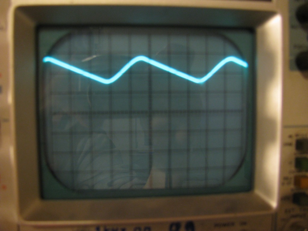

I have another idea: Look at the output of pin #1 of U603 leading up to the fault. It should be an indication of whether the current is increasing on the 12V supply.

worth a try, i'll post the result in a while
okay, pretty huge difference between okay and faulty state.
video is at from faulty state (link)
https://onedrive.live.com/?cid=4773...228&ithint=video,AVI&authkey=!AOWeesKPIfRQSzM
picture is at okay state.
2 volts/div is at both and dc-selection
couple obesrvations using freezer: fault disappears when bridge rectrifiers are hit. also, beam disappears (still backlight is abnormally bright) when opamps are hit (u603)
figured that would be next step, what do you think, there are two bridges, should both be replaced?

I looked, there are 4 big caps in the power supply. Rate at LEAST 2x, the voltage seen.
What's the p/n of the bridge? Current and PRV?
MAYBE, they need to be upgraded.
Replace both bridges? Dunno. Get the p/n from the component and the original specs.

cotcha, but i see only 3 ''big'' 2 pcs of 1000uf/35v, and one 47uf/200v (plus 250v/2.2uf so yeah, that makes four.....). I suppose you mean more voltage for those 35v but is it really nececcasy for that 200v? or by voltage seen, did you mean what i see via meter/scope?
as far as i can see from schematics, p/n is either 1G4B42 or IG4B42. That shouldn't be issue, as they both return datasheets, only from different manufacturers. Average output current is 1A and PRV is 400v
The 47 @ 200 V has been replaced. The schematic says 25 V. I'd get a lower tolerance cap there, e.g. +-10% vs -10%+75%
Bridge: PRV of 100-200 should be fine.
IF it gets all fixed, we can select a couple of surge suppressors, TVS diodes, whatever. Not now - they are too expensive.
youre right! didn't expect that at all, i mean that it have been replaced.
hopefully, feels good scope so far, easy to use, overall shape seems good (except couple calibration knobs missing, but they are in ''normal'' selection
but, i'll buy the stuff, right after i get answer to this: opamp is μpc4558, and hard to find excatly that. what are gualifies as replacement? with 4558, i can find LM4558, MC1458-8P
as for stuff found so far, these should be okay right?
