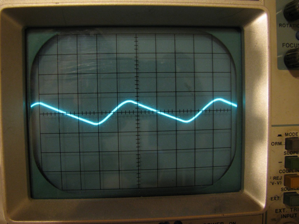

2 V p-p might be too big. This is on the +12 and -12 supply caps? Do the waveforms look different?
throbs: The 12 V supply oscillates badly at fault, supposedly.
oh yes, main filter caps, and no, waveforms are like sawtooth, only bit rounded on edges, like normal ripple (at least i think so....)
cap voltage is seen at photo
oh, and caps voltage oscillates same time as fault ''blinks''
