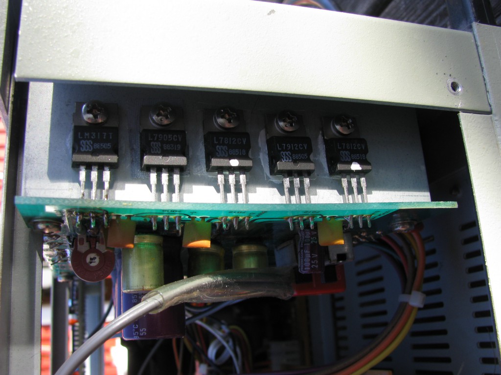

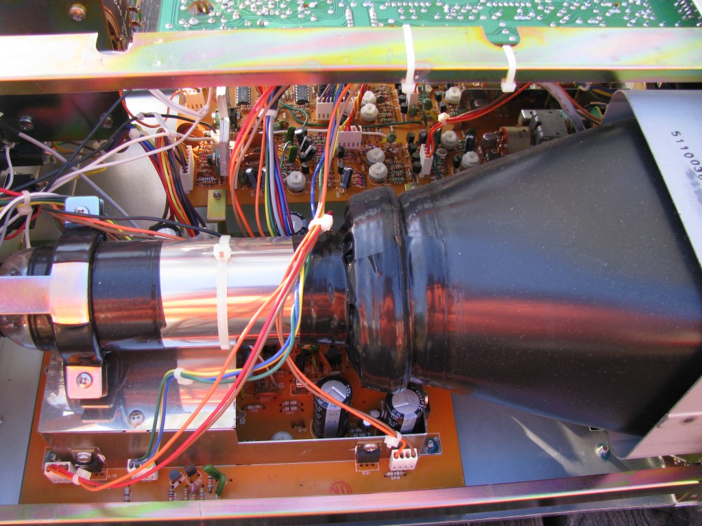

But back to topic, the scope that gives smoke, has something weird in PSU section, heat haze/smell/smoke comes from there, and the picture shows lm317, which gets pretty hot pretty fast, as does transformer, which is alarming sign, i mean that transformer is too hot touch!.

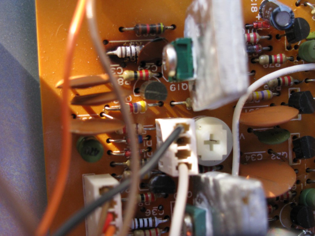

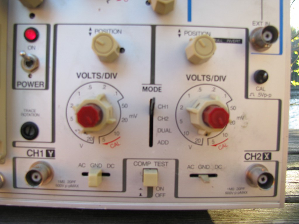

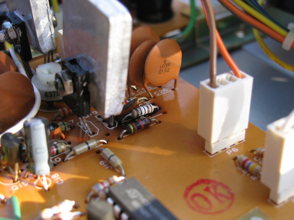

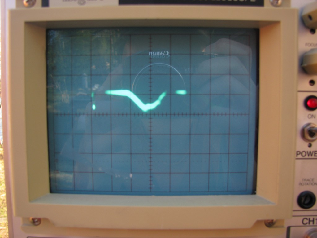

The other scope, which has distorted signal, has fuzzy signal no matter what are knob's settings, see from photos gnd-settings on both channel. it does swing and change amplitude in x-axis when frequency knob is turned, but only one sweep, sometimes not even that, sweep stays at the left corner. Quite hard to take picture..... And i did find one burnt-looking resistor, hopefully you'll see is from pictures. There seems to be other symmetrical portion, where all are same on pcb, but of course resistor isn't burned looking. If i recall right from amplifier troubleshooting, oscillation can kill resistors/transistors, but what do you think about these two(three) faulty scopes now, as there is some info in hand?

ok small update. that kikusui which started malfunctioning couple days back, i found one resistor that was came loose due bad solder from heat of two 2w/4.7k resistors connected in parallel. I installed loose one back in its place, but problem still exsists. I noticed also that capacitor problem shouldn't be far away, as i noticed one capacitor, seems to be main filter caps, is pretty hot. There is heatsink near it, but it doesn't seem to radiate heat to cap, instead it seems heat is developed inside capacitor. Excess ripple current? is it normal for caps to heat themselves?
also i noticed strang thing. when this fault comes, screen illumination is illuminated BRIGHTER than when it's working correctly, and when brightness is adjusted quickly, screen tries no something on screen, but in bad result. Also there is dim, hazzle in screen when backlight is dimmed

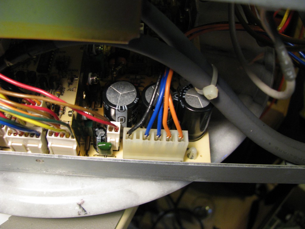

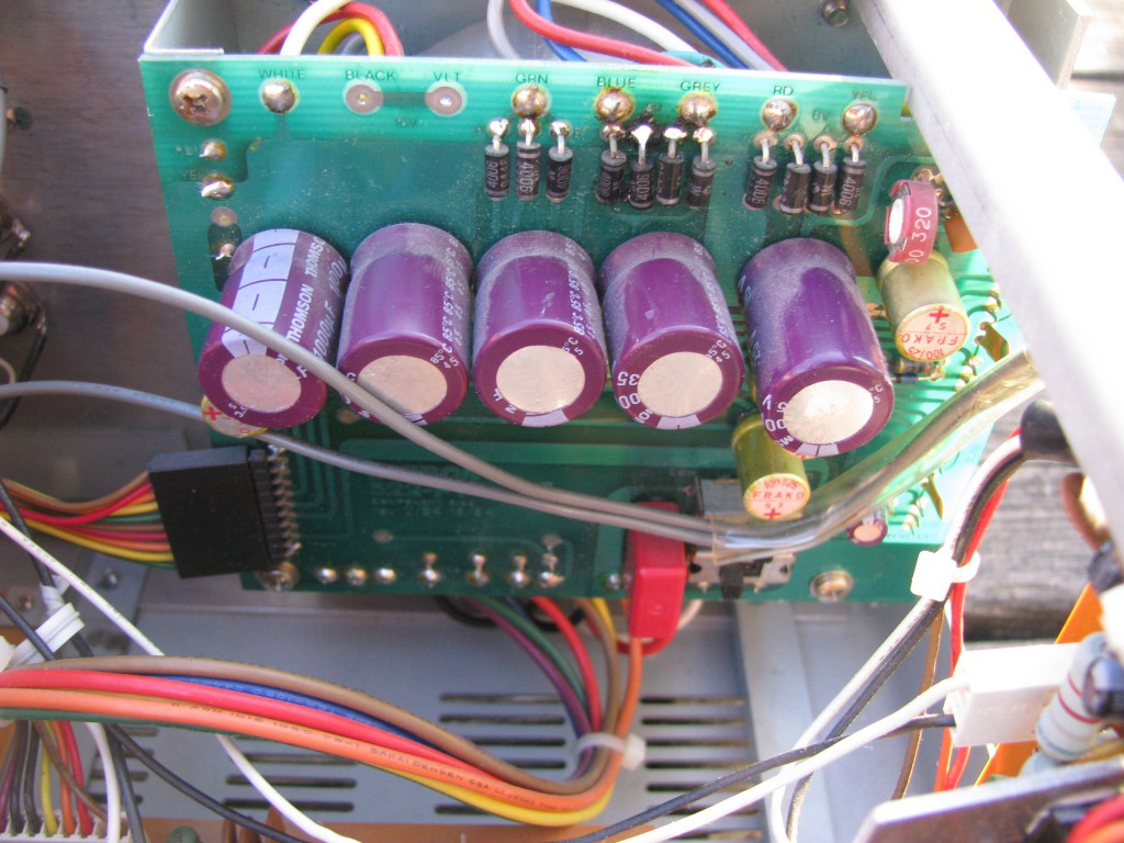

ok measurements made here's the results, there are 3 same size, but different rating caps
mains smoother rated 200v, measured 200 volts.
35v rated, two of 'em, measured them separately, measured 9 volts when ''fault'' is on (bright backlights) and when signal comes to screen, voltages rise on both to 19v. And, the hot one is another of these 35v caps, but that is still next to heatsink.
see the photo, caps are shown, 200v rated is rightmost, and that big chung of wires comes straight from transformer. and just for satety's sake, i do use isolation transformer....

Fez...you have it wrong:banghead:
Horribly wrong:(.
I believe you cannot tell the difference between Primary and Secondary stuff on Power Supplies...and that really is a huge problem..
I doubt this is even SMPS...I believe it's a Linear Supply.......
Even worse.
I don't know what else to think/say......confused :nailbiting:
what? it says 200v/470uf on cap, and i measured it across the cap terminals on dc-setting on dmm, what did i do wrong? :S...
