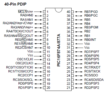

Hi. The PIC16F877A has RA0 to RA5, doesn't go to RA7, see attached pinout diagram. Here is a link to the data sheet:
