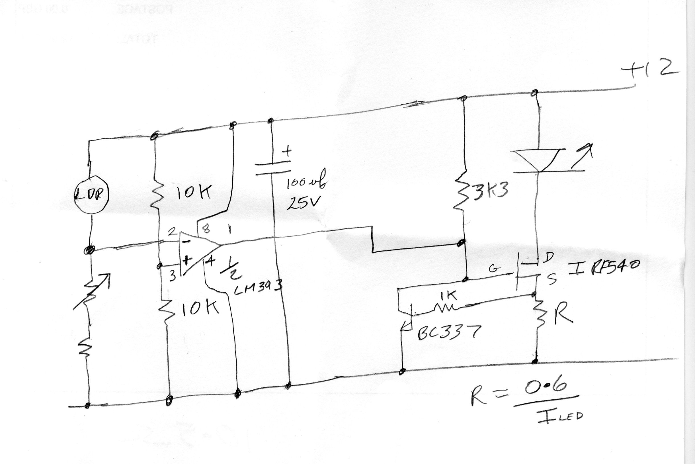

Here is a circuit that I think will do what you require.
The value of the fixed resistor and potentiometer will have to be calculated using the data sheet for the LDR. The potentiometer 's value should be about the same as the dark resistance of the LDR. The fixed resistor should limit the current to less than the LDR's current rating. You need to calculate the value of "R" to match the current rating of the LED and it's wattage to match the power dissipated in the resistor. You may have to adjust the value of the resistor slightly from the calculated value to get exactly the current you want through the LED. The left hand side of the circuit does the switching. It shuts down the current regulator when the LDR is illuminated. The right hand side is a current crude regulator to control the LED current. I have not built this but it should work.
Les.

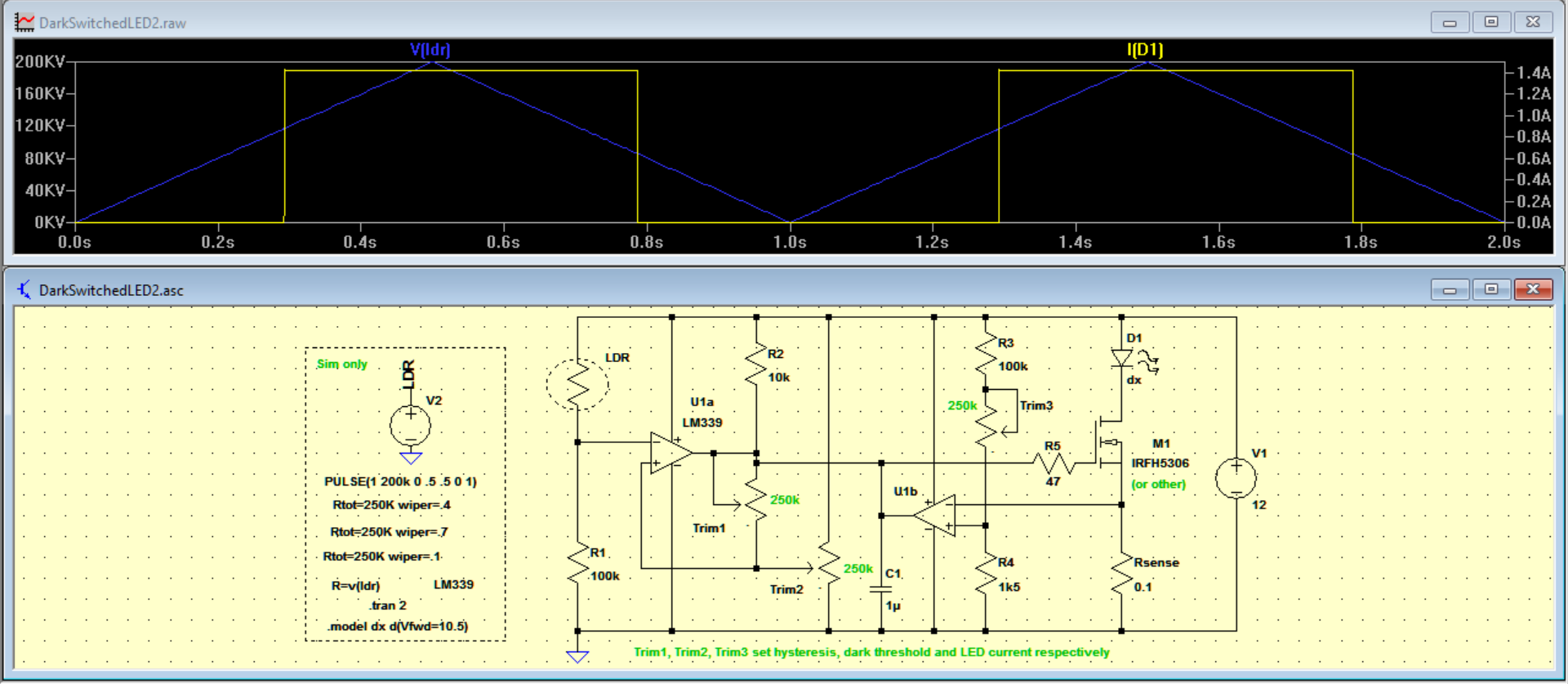

Here's a variation on Les' circuit, using the other half of the 393 (dual comparator IC) instead of the BC337 to provide current regulation, and with hysteresis added to the first comparator so that passing clouds etc don't cause false switching of the light. Trimmers allow adjustment of hysteresis, dark/light threshold and LED current.
The blue graph simulates LDR resistance. For 'kV' read 'kΩ'.
Note that, as with Les's circuit, a small heatsink will probably be needed for the FET (as well as a large heatsink for the LED). A 100uF cap across the supply, as Les shows, would be advisable.

Your circuit is better than mine for a number of reasons. 1 You have added hysteresis. 2 Your constant current circuit uses a more stable reference voltage the the vbe of a transistor that I used. 3 It uses a lower reference voltage which means there is less voltage drop across the sense resistor. This is important in this application as we have very little voltage to spare for the constant current regulator. (12 volt supply and I assume 3 white LED forward voltage drops only leaves about 1.5 volts.) Thanks for mentioning adding a heatsink to the power MOSFET. I forgot that the OP has no electrical knowledge.
Les.
