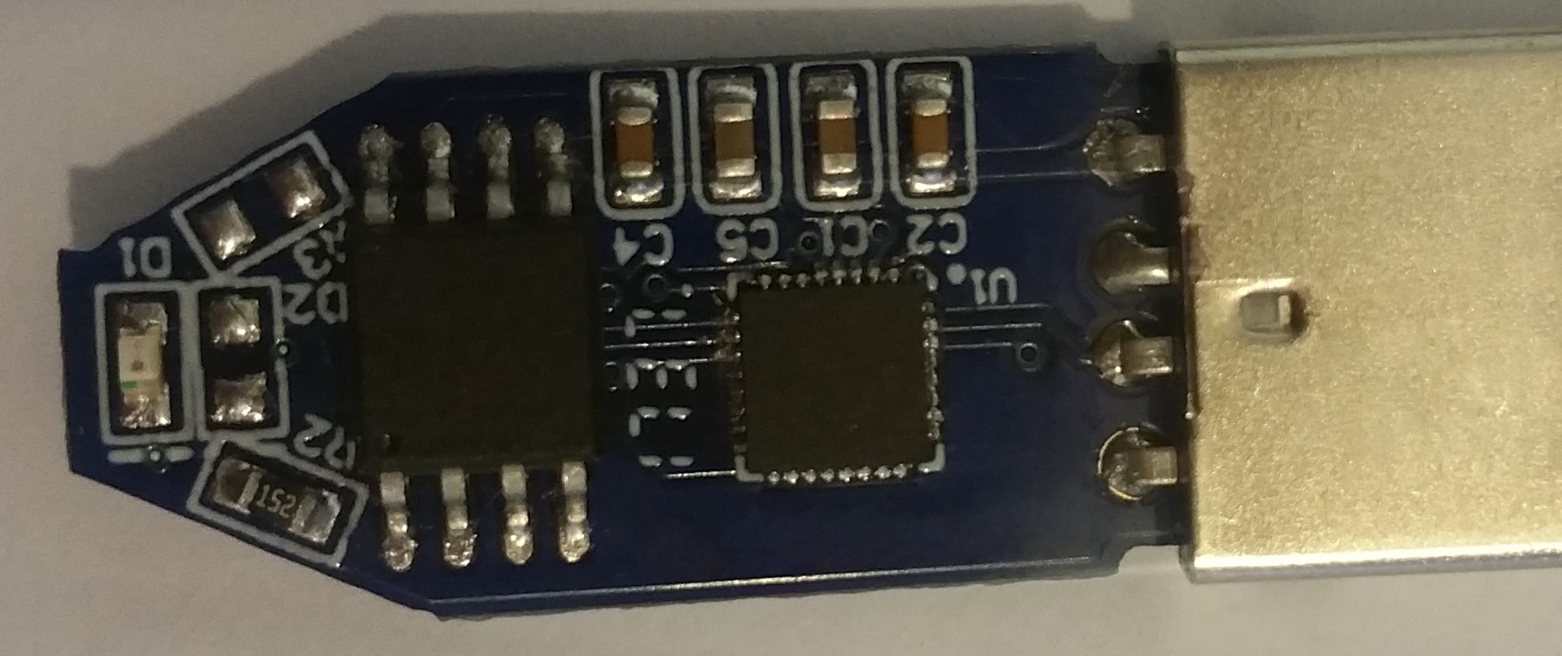

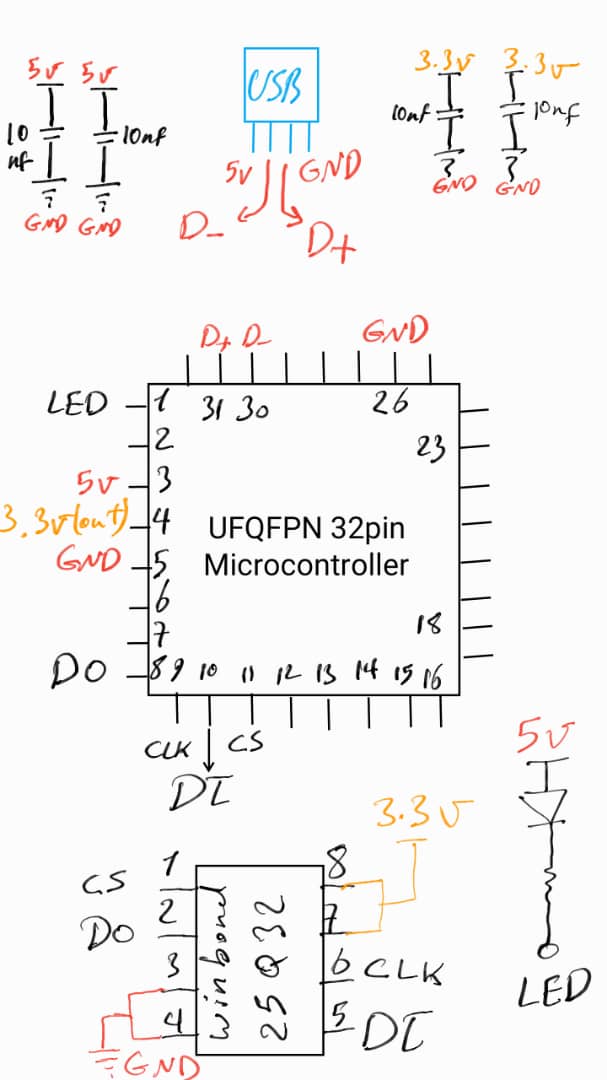

The chip I want to identify is a micro-controller with RSA cryptography acceleration utilized in a USB module. I suspect it is a chip manufactured by Chinese manufacturer and it might not be a general purpose product as well.
This is the schematic I extracted from the board:
And this is the board photo:

If this link works. It takes you down from 80,000 micros to 400.
32-pin, USB, (you can sort more)
You need to pull the data sheet on each and look for USB on pins 30,31.
This only works if it is available from DigiKey.com

I never said I was going to duplicate that device. I'm just in love with that minimized PCB board!
I just could not find a <low cost, RSA-accelerated, USB-interfaced micro-controller which requires minimal driving elements with minimum package size< in my searches. but I had this sample product. I'm testing my luck to hit someone who knows the chip.
Again, if it was not clear, I don't mind the product. I want such micro-controller to design my own board.
