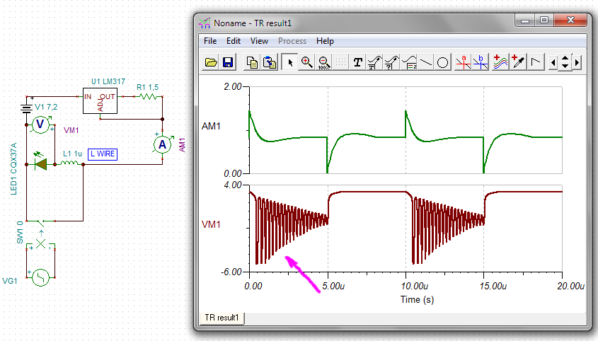

Accidentally short circuited LED generates spikes in current and produces large reverse-voltage spikes, which destroys LEDs (wire self inductance).
Regards,

The diode probably died because it was shorted out and caused spikes in current and produce large reverse-voltage spikes as Zabb Csaba said above.

I Really Doubt a Spike like that would burn it out, Unless it was a LONG Pulse of Current.
Usually you can PULSE Led's at Currents Much Higher than there Rated Current, For Very Short Periods of times.
I have successfully Pulsed 20 mA Led's with Short Bursts of 250 mA pulses.

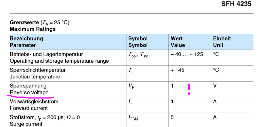

You will protect the new one from reverse-voltage spikes with an anti-parallel Schottky diode (1A).
Regards,
Csaba

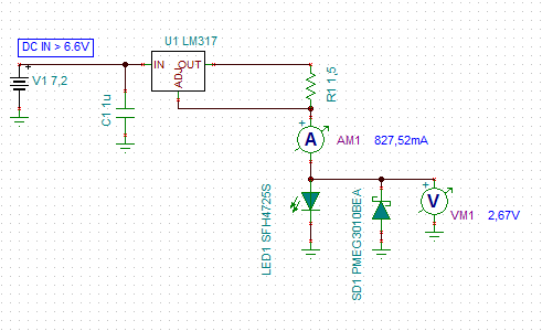

they are all 1A maximum Forward Current and the lm317 will be with 1,5 ohm resistor again
and will supply 1,25 / 1,5 = 0,83 A = 830 ma running them on 83 % of power.
and can you draw me in paint a diagram where i should put those Input and Output Capacitors for Stable Regulation, and that anti-parallel Schottky diode for protecting from reverse voltage.

Ideally 1 uF Tantalum Caps.
(Or 0.1 uF Polyester Cap if you can't get tantalums.)
One on both the Input and Output to Battery Negative.
Diode, I just use a Regular 1N4001 Diode.
But you could use a 1N5819 Schottky diode.
Diode Line Side to Input, Other Side to LM317 Output.
(Not the Adjust Output as needed for the Current Limit.)

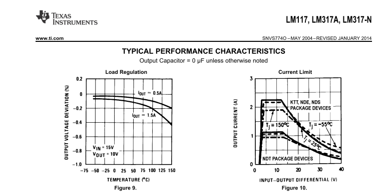

An input bypass capacitor is recommended. A 0.1 μF disc or 1μF solid tantalum.
The LM317 is stable with no output capacitors.
Protect the LED with fast Schottky diode. Place the diode as close to the LED as possible.
There is no need for protection diode(s) for the LM317 in this application.
All the best,
Csaba
thanks for the final driver diagram, I ordered everything i need it can take up to 30 days to be delivered so will report back then.

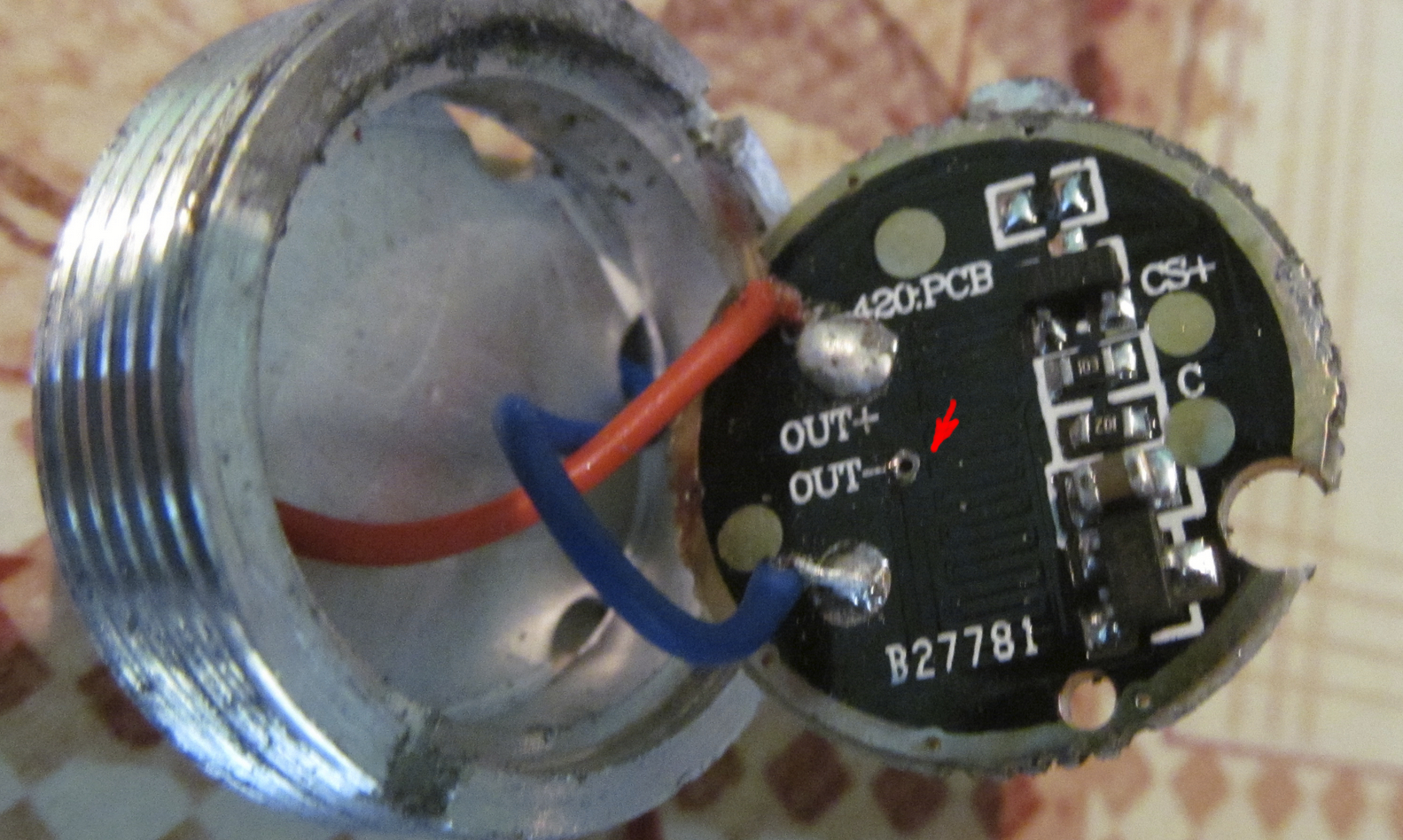

it is the same diode only mounted on a heatsink, i also fount a small driver for white cree q5 diode it is on a board 18 mm in diameter, and it gives 1060 ma i measured with multimeter when white led was glowing. it works with ONE 3.7 v li-ion baterry
is 1060 ma too much for my ir diode that i ordered or should i stick with my lm317 homemade driver, i don't want it to die again like the last one ?

Unfortunately I cannot see exactly what is on the picture but I think it must not be a current generator.
But it can be current sensor which may be needed if you use the factory power supplies suggested to the diode.
Currently it doesn't work for you. So you need the external current generator(LM317) and do not connect the LED directly to the battery. I found this in the PDF:
"Do not operate PowerStars with a Power Supply with unlimited current. Connection to constant voltage Power
Supplies that are not current limited may cause the PowerStar to consume current above the specified maximum and cause failure or irreparable damage."
