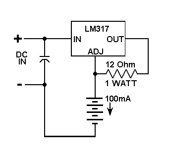

A BETTER CIRCUIT would be CONSTANT CURRENT Controlled.
The Problem with this circuit is If Any Part of the Battery is Bad, It will Deliver EXCESSIVE Current.

This is Why a "CONSTANT CURRENT SUPPLY" Would be "MUCH BETTER".
For this type of Charger, Ideally you want a MAXIMUM Current of 1/10 of battery Capacity.
So for 1200 M/AH Batteries, a Charge Current of 120 mA or Less.
give me a circuit diagram of some constant current chargers for my case if you have.
and if it helps i have already few LM317 regulators.
Here is the Circuit.
But DO NOT Short out the Output.
Input to Output Voltage Can NOT Exceed 40 Volts
