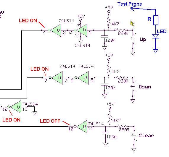

sir i rewired the circuit and got 0 0 initial display.. i made a 5v power supply thru 7805.. the problem is, the switches wont work..

Test the voltages [using the LED wire] and see what the 74LS14 pins # 4, 8 and 10 show,,, let me know.

Look at this image, test the points I have noted.

ok, dont panic!:)
1. Connect the test LED to pin #4 of the 74LS14, the test LED should light, now push the UP button, the test LED should go dark.
2. Connect the test LED to pin #8 of the 74LS14, the test LED should light, now push the DOWN button, the test LED should go dark.
3. Connect the test LED to pin #10 of the 74LS14, the test LED should light, now push the CLEAR button, the test LED should go dark.
Let me know exactly what happens when you do this test.

hi sir
test point #4, UP button pressed, LED OFF
test point #8, DOWN button pressed, LED OFF
test point #10, CLR button pressed, LED ON
sir as you said earlier, on pin 10, LED should be off?
That part is working OK.

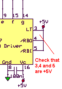

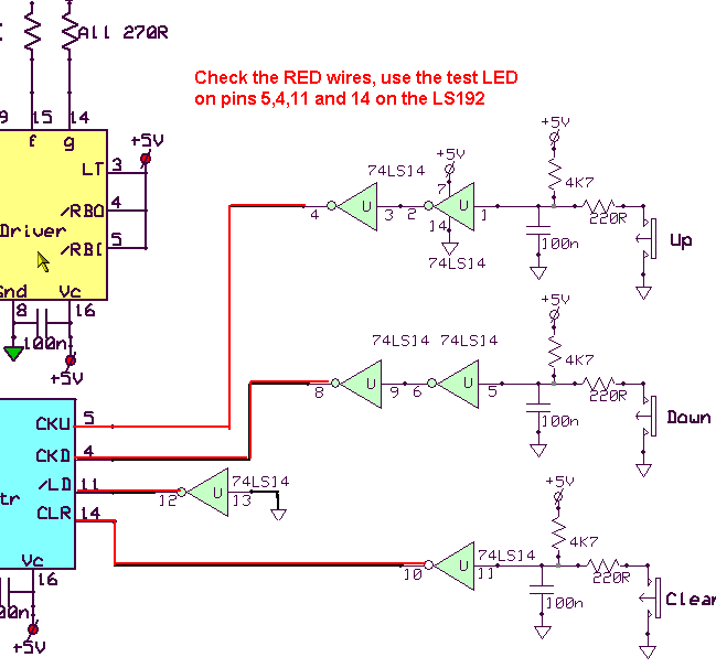

When you have done the pins 8 and pins 16 test, look at this image and do this test.

Now do this test.
