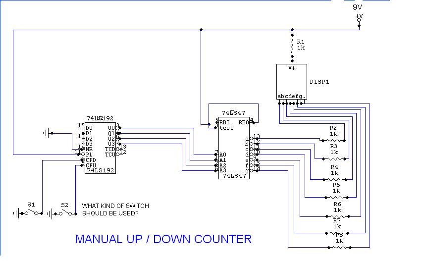

this is a school project.. i am assigned to make a digital scoreboard (basketball) or an up/down counter.
it should be a manual input using a switch. (push a button then the score increases, or push another button the score decreases)
my materials are:
7 segment common anode
74LS47
74LS192
1k ohms resistors
push button switches
i need a schematic diagram to follow.

attached is a proposed design

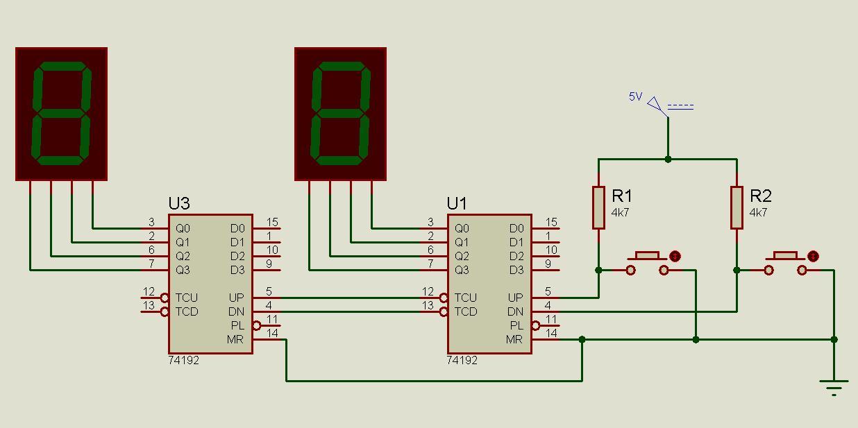

here is a design i found, will this work?
i understand that between the display and the 74LS192 is the 74LS47.. i already have the idea how to connect them.. my problem is just the switches.. to make it go up when i push a button, or go down.

Will this circuit work?
I made a revision on the circuit. Will this work? And what kind of switch should be used? Is my connection for the switch proper to make it count up or down? Thank you so much!PROPOSAL..JPG
I made a revision on the circuit. Will this work? And what kind of switch should be used? Is my connection for the switch proper to make it count up or down? Thank you so much!View attachment 40874
hi patrick,
You cannot use 9V on the 5V TTL devices, otherwise its looking better.

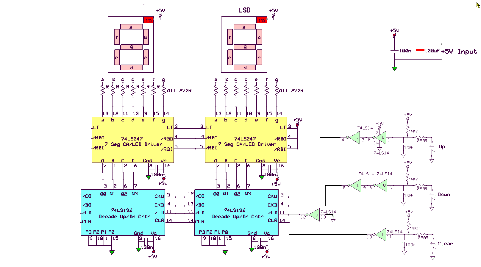

Have you looked at that link I posted, the coloured drawing is almost what you are looking fro,

You need at least 2 push button switches, one for UP and one for DOWN count.
I have added a 3rd CLEAR push button, if you need to add a LOAD button later on, use the PL pin.
The 74LS14 will debounce the switch contacts, so that you will not get multiple counts when the buttons are pressed.

The 100n is a 100nF capacitor also marked as 0.1uF.
The 74LS47 and the 74LS247 have the same pinout.

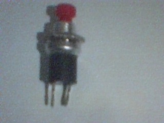

sir eric, i attached the picture of the switch.. it bounce back when you push it, the initial display upon turning on the circuit is 0 4

OK, see that looks OK.
