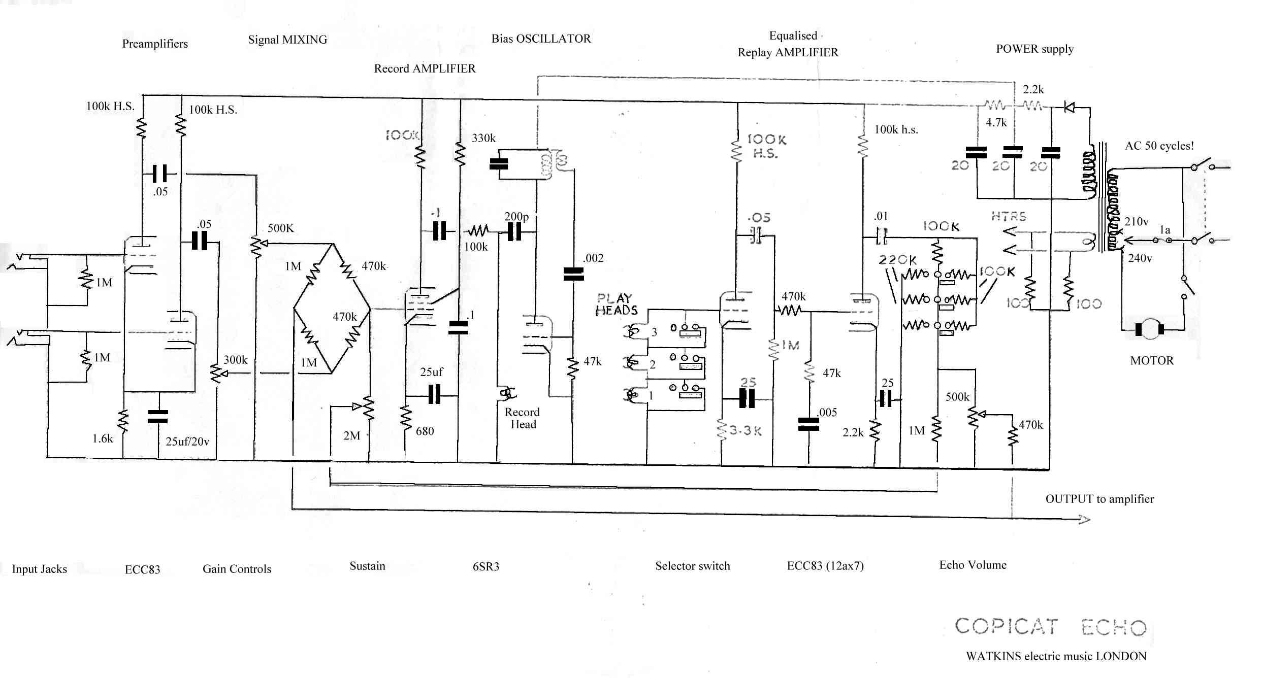

While looking through some more schematics, I found one that seemed like it would be a lot easier to produce and understand. It does, however, use tubes rather than solid state components. Is there any way I could change the circuit to work with transistors? Here is the schematic;
http://www.vintagehofner.co.uk/britamps/watkins/schematics/copicat.jpeg
Also, I'd probably want to lose one of the inputs, and 2 of the 3 play heads. Can this be easily done?

That's the site I posted the link to above already (didn't you try clicking on it?), I specifically posted the link to a simple IC circuit, but there are transistor ones and valve ones there as well.
Incredibly easily - they even include switching for the different heads.

I did look at that circuit in detail, but it seemed like the schematic I posted might be easier for me to build, if transistors could be used instead of valves.
Look at the other circuits on the same site, there are at least a couple of transistors ones (older versions than the IC ones).
However, the IC versions are probably the simplest? (opamps make things easy).

Ahh, this is excellent. I think I understand this one. I have a couple of questions. What voltage is the rectifier outputting? In other words, if were to use some kind of DC power supply, what would I use? Also, how would I go about getting/making the bias transformer? Thanks btw, this is so helpful.
