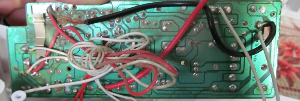

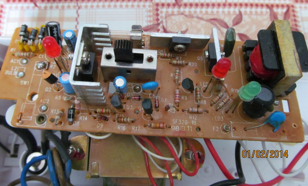

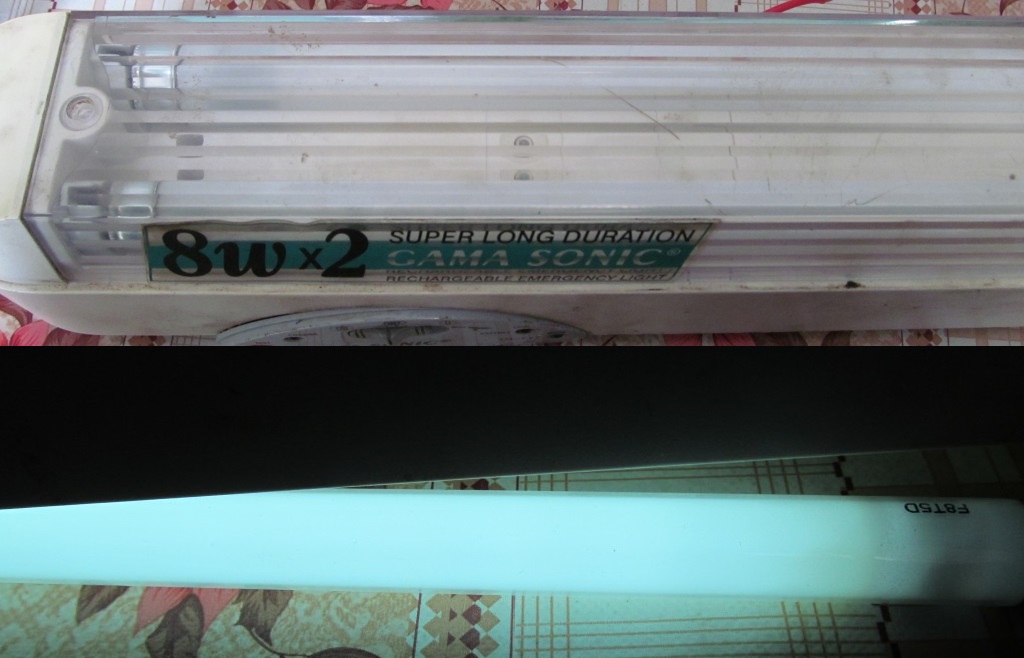

here are some pictures:

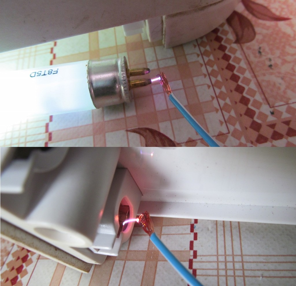

the driver circuit, i think it is also an inverter but high voltage because i can draw does 4-5 mm hot arks from it when i connect the two ends where the lite tube goes. i also tried to connect one end of the tube to one terminal where it belongs an the other end i hold with finger and touch the other terminal with my other hand and i lite up but it has to have a got connection because if not it draws an ark on my skin and it burns.
on the third picture where is the driver, there is a transformer below, it was used to charge a original 6 volt battery which died, so a now run it on two baterys of 3,7 volt, and charging the on another charger.
those twisted white wires are from the charger transformer, red and black are going to batery.
and now i want to make an induction heater out of this if possible, if not please someone give me a tutorial that i can follow.
thanks in advance.

1. what kind of output current is this board on the picture give ac or dc, and approximately what voltage.
2. can i build an induction heater out of this driver or would it be easier to build it like in this video:
3. can this driver be an inverter that converts 6-9 volts of dc to 6-9 volts of AC and not that high voltage
That looks like a resonant induction heater circuit, probably run from around 12v and the coil volatge is probably about 20v, but dont quote me on that.
For heating your feet you want maximum efficiency to minimize battery use and an induction heater has low efficiency. Resistive wires in socks are near 100% efficient. As Alec said you are way over-engineering this.

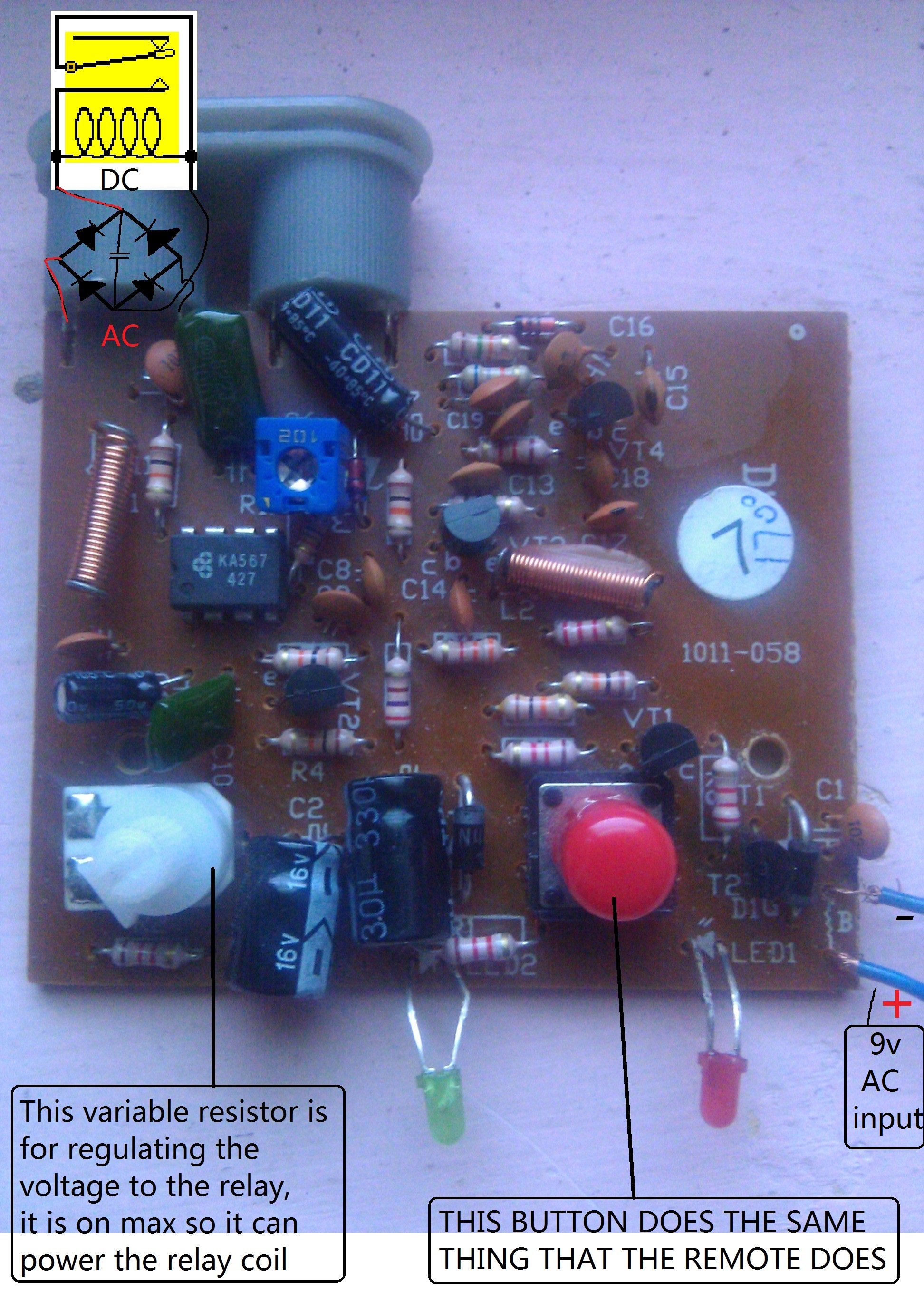

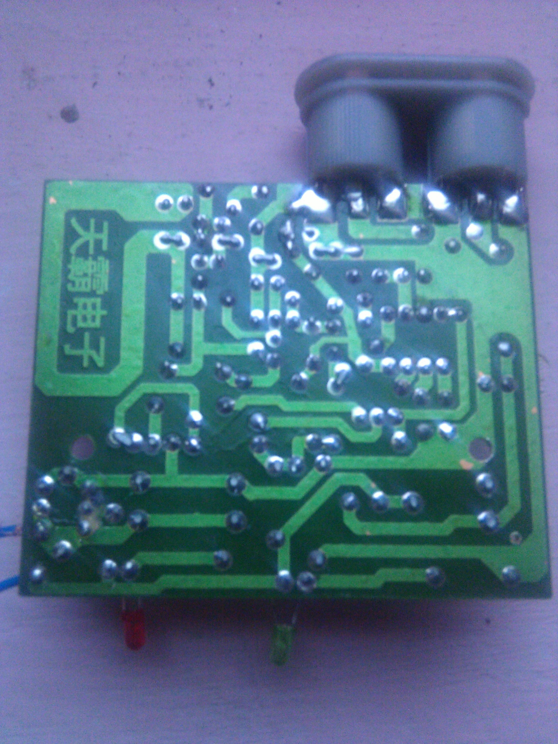

and one more question i have an RF module switch ( works on 100 meters with an litle antenna), with a remote for it, that RF module was used for spinning an TV antenna outside my house, and now i have satellite tv and don't need this one, so i putted a relay on it and now it is a RF switch, but the problem is that it works on 9 volt AC power, and i cant use it with battery and i need it to work with a battery, so can i get 9 volts AC from that board above that a posted pictures before ?
Try it with a 9v battery, it might work, the rectifier will osrt out the polarity for you.
Being 9 VAC powered if it rectifies and filters it with a capacitor the internal systems may be working on roughly 12 VDC.
on the RF module i have 2 led: red ( power ) and green which only flashes when i press the remote, i tried it with 9 volt battery and the red one is glowing but when i press the remote the green is not flashing and the relay is not powered. i looked on the RF board there is no sign of a rectifier that converts AC to DC, and when it is working on ac transformer when i put a relay on the output where was the motor for spinning the antenna the relay is osculating fast so i put a rectifier and a capacitor to convert that AC to DC for the relay - switch.
ok, i will buy a 555 timer and build an small low power inverter.
