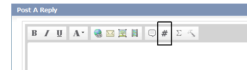

hi B,
As hexreader suggests it could be your Code.
Use the '#' Hash symbol when posting Code it preserves the formatting.
Dont use the '@' symbol in your posts it puts the post in the Moderation check queue.
Eric
