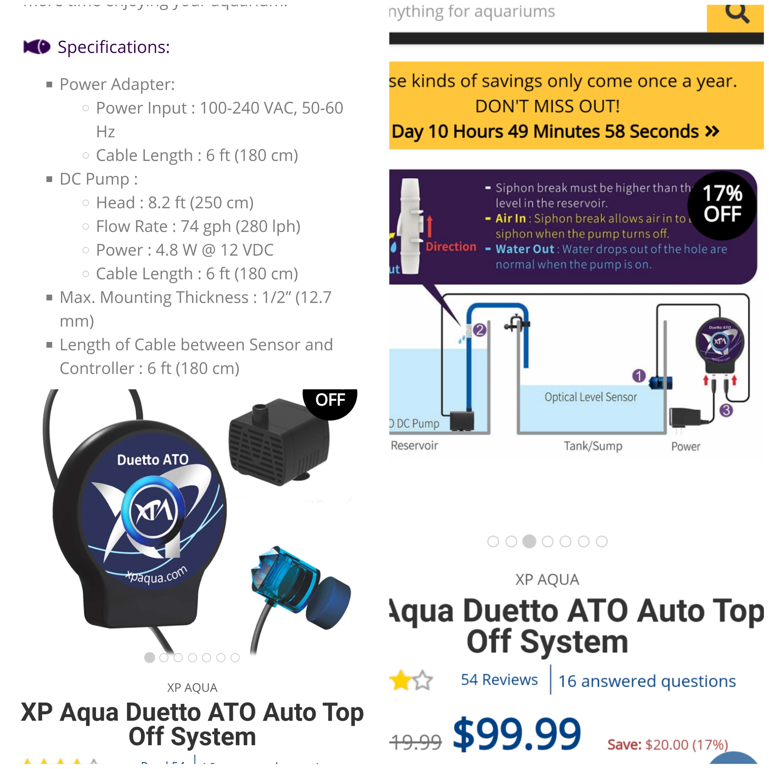

I'm trying to power power a small micro controller + DC pump 4.5watts at 12v dc.
The adapter I'm using now is 12v 1a 12w to a standard 5.5mm/2.1mm barrel plug.

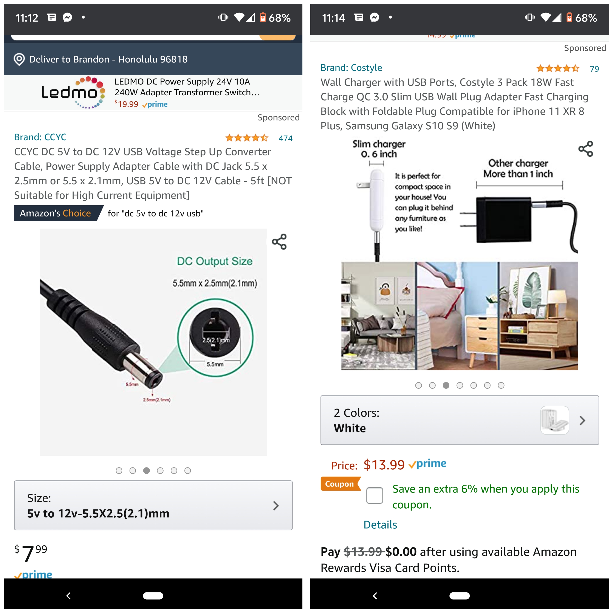

What I can find are incredibly slim USB wall adapters but they're all rated at 5v. And I can find USB to 5.5 mm/2.1 barrel plugs.
The ultimate question is can I use a USB adapter with at least the same wattage and amperage but a lower voltage for my system.
It can be done in a convoluted and inefficient way.
You would have to have at the load side a 5 to 12 volt boost converter.
You need 12V unless you can find a 5V pump.
Or could I use something like these two in combination?
That should work. The power rating of the wall charger and the power rating of the 5 V to 12 V adaptor must both be larger than the power rating of the water pump.
It is a convoluted way of doing it, but it uses cheap, off the shelf components and it should work, so it is probably the best solution. I would not advise trying to make something that fitted into a 1" gap and works with mains voltage. That is very difficult.

I don't know of any slimline wall wart style, but could you use a "brick" type with a trailing power cable, just swapping the power plug or cable to a right-angle one to keep the depth down?
You have a separate item in a cable as you would using a 5V unit and separate voltage converter, but it's ready built, fully insulated and ready to use.
eg. This one is a bit higher current that you need, but that should not matter, it will just run cooler and should have a longer life:
There are plenty of others that could be suitable.
Example low profile plug power cable that should fit the above brick:
Again, there are many types and lengths available.
