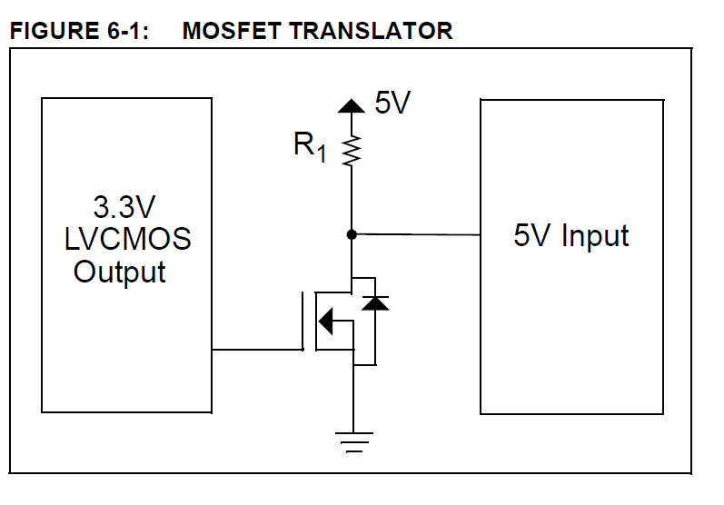

I've been working with changing design requirements for an upcoming micro. There was need for an SPI eeprom of 64KB, that has since changed to 1MB+. The space on the pcb is really only going to allow for an soic-8 or smaller chip. I was going to use a 5V tolerant microchip part but they top out at 1Mbit. I've found an STM part that will work but its 3V max.
The 3V output from the rom is not enough to trigger the pic's input as High.
I've secured enough room for the chip, an sot-23 regulator and some level shifting.
I've got two options, one is to use 3 small sot-23 mosfets that will each need a resistor to do the level shifting, the other option is to use an integrated level shifter.
I'm slightly concerned of the transition time using mosfets as the source resistor may cause problems at 10Mhz (or leak too much current at low level). Likewise a concern with the integrated translator is that I don't have a level shifter picked out and haven't so far seen a 3bit or 4bit that is small enough.
Recommendations ? Thanks

I have seen that, and the site it came from. I don't particularly like it thought.
Its more complicated then <attached> and for SPI (unidirectional) adds nothing for function. I'm not sure why the site that came from lists that for SPI when there is a much simpler solution.

Papabravo: Those are some of the parts I came up with as well. I'm stubborn though and would prefer to find a signle soic8 or narrow so14 package that did 3 or 4 bits. In reality having 3 sot-23s is probably going to occupy the same amount of space, but I have a more confusing board layout with a more complex BOM and refdes. If I do find room for a daughter board I'll probably use that ON part.
Pommie: 4.3V is a good idea. I'm not sure how it would effect the rest of the 5V devices on the board (most importantly the CAN transceiver). That would allow me to receive data from the 3V rom, I would still need 2 level translators for MCLK and MSDO to knock the 4.3V down to 3V, CS would just be a 3V pullup the micro can ground. So that would save one more buffer. Stupid non-5V devices (Or when I transfer to a smaller die chip - Stupid high power 5V devices)... I've noticed my view on technology is really limited to how it effects ME at any given time :)
I need to check some header parts, hieghts, and get everything into my 3D model but I think I may have room for a daughterboard if its needed later. That would let me use a 1Mbit 5V rom now and then plan for later.
I'm not sure of the difference between using ON's translator vs a simple mosfet. Its probably just a predictable propagation delay and current usage. Since I'd probably just use a sot-23 mosfet there is no difference just using the ON part.
