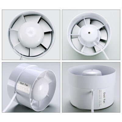

Look for "Inline extractor fan"
A 5" / 125mm should be about right.
eg.

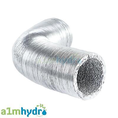

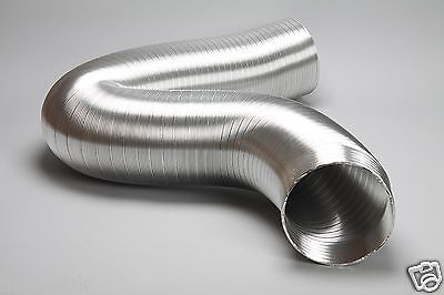

Add duct such as this:
or this, etc.

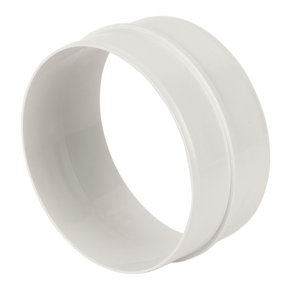

The below looks the thing, but looks to be too smooth and not having facility for connection of ducting either side of it?
The ducting just slides directly on and clamps to it, as if it were a coupling sleeve, as below!
What more do you need???
I bought an industrial cooker hood, and some 4" ducting.. Only cost £50 for the hood ( second hand ) and pennies for the foil expandable ducting.
