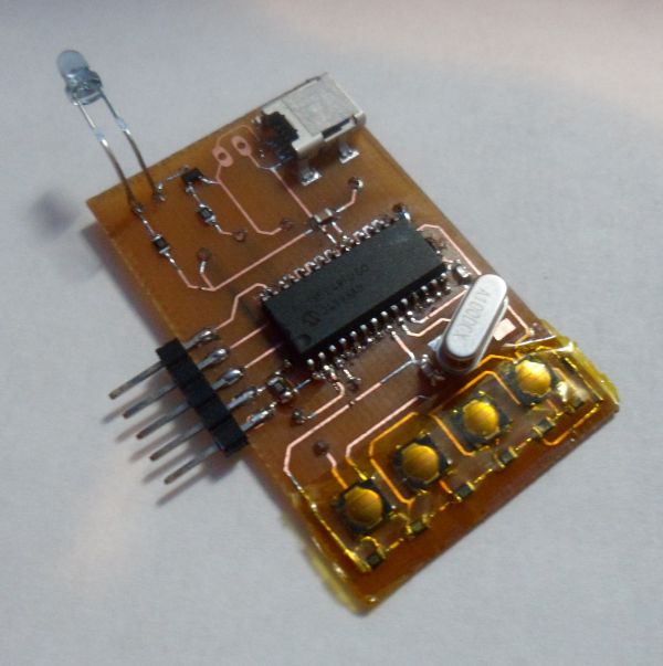

Here is a picture of the prototype remote:
rem-jpg.54045
Please, can anyone explain to me how is interpreted 10 bit value of adc in this application ? And how is key press decision repeatable comparing a single value, not an interval.
Your not you could send out the numbers and then read them.
