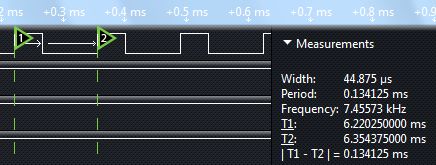

ok im going nuts here... im using timer 0 as i have done in the past... im using a 18f2525 now...
Im using a 8mhz internal clock... so thats 1/2mhz = 0.0000005 = 500ns for 1 cycle
		T0CON = 0x88; //Timer0 ON , No PRESCALER
		IRPIN = 1;
		while(TMR0() < 18); // 18 cycles is supposed to be 9uS
		CLRTIME(); // clears TMR0L and TMR0H
		IRPIN = 0;
		while(TMR0() < 35); //35 cycles is supposed to be 17.5uS
Now what i see in my logic analyzer is :
		IRPIN = 1;
[B]		while(TMR0() < 18); // 44uS which is more like 88 Cycles[/B]
		IRPIN = 0;
[B]		while(TMR0() < 35); //88uS which is more like 176 Cycles[/B]
why am i having this issue?
ERR here is a screen shot of logic...
err-jpg.54023
Here is my full source... also.. didnt want to release it until it was complete but im sure it can help fix my issue:

Ok SO FAR SO GOOD!

Timing is like 99.2% correct.
OMG im using my NEC reader and it reads the signal fine.. but my tv volume doesnt change

If you have the logic softwae (FREE)
https://www.saleae.com/downloads/
You can check my output...
  • NEC.zip
Looks sort of reasonable at a quick glance. I will check more carefully when I get back from work.
Don't suppose you have a working signal (from your universal remote) to compare it to?
How do you know what device address and button code to use anyway?
I actually do have a remote thats how i made my nec receiver... It can decode the remote and give me address byte and command byte and displays it on lcd. Ill make a video in a little then upload my remote ir captue from logic and the universal remote capture also so anyone can compare the. The differeNce isnt big. Im following the exact protocol from sbprojects ir pages
I read your logic analyser trace as (hex) 20-df-40-bf and the timings look correct to me.
Does your NEC reader read all 4 bytes? I presume that it does, but if it did happen to only read bytes 1 and 3, and assume bytes 2 and 4 to always be the complement of bytes 1 and 3, then the problem might lie there.
Many remotes treat bytes 1 and 2 as a 16 bit address, rather than 8 bit address with complement byte.
But then....... you probably know all of this already.
Can't see any obvious reason that your remote is not working.
Will be interested to see the logic analyser trace for the working universal remote.
hah i got it working! had to send 1 extra end pulse
